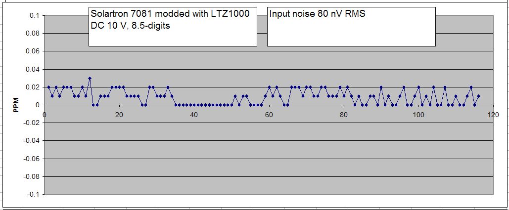

发表于 2014-1-16 01:21:27 | 显示全部楼层
iddqd2001 发表于 2014-1-15 02:02
Do the same thing with the Solartron 7081. Noise is less than Advantest R6581!
Noise is less than Advantest R6581?!Who?Solartron 7081 or Agilent 34410A?
I had a 7081,the input noise up than 900nVrms @10V Range、8.5d(it=51.2s),as a comparison the 6581 input noise less than 300nVrms @10V Range、it=200ms。Input noise by 34410 was also to less than 300nVrms but integral time > 2s。

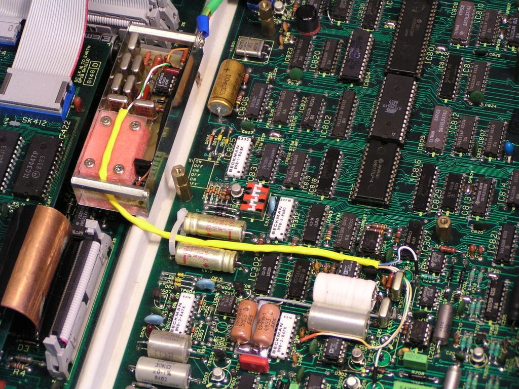

发表于 2014-1-16 03:10:48 | 显示全部楼层
Solartron 7081 mod with DIY LTZ1000 reference board
