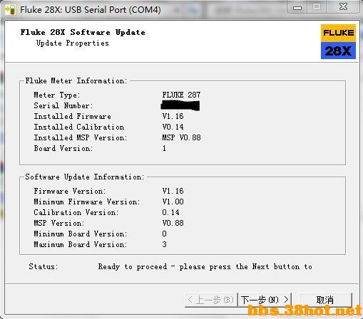

发表于 2013-5-23 07:23:46 | 显示全部楼层
http://www.fluke.com/fluke/usen/support/software/DMMUpgrade.htm
最新的是1.16版本
This upgrade includes these new or expanded capabilities:
  • Corrected an issue where recording sessions could be interrupted or terminated when using the record function in combination with ambient conditions of bright sunlight or other sources of bright light, when used without the IR cable attached.
  • Zoom on trend provide unprecedented ability to view analyz TrendCapture data; see detail at X5 magnification.
  • Rotary switch memory when switching positions between AC or DC A/mA and uA.
  • Adjustable recording and auto hold thresholds, specify a percentage change in the readings that begins a new event.
  • Logging function with expanded memory for unattended monitoring of signals over time. Using on-board TrendCapture users can graphically review logged readings without needing a PC. Store up to 15,000 recorded events.
  • Simplified Record screen when setting up recording.
  • New and improved Trend View graph plot. This new plot algorithm plots the minimum, maximum, and sample point for each sample interval record and event record.
  • Allows 5,000 to 15,000 recorded events for each recording session (events are different than sample intervals).
  • Improves the speed of plotting the trend graph in Trend View.
  • Added fast scrolling through trend data. Useful when viewing trends with large number of events and interval samples.
  • Resolution of plotting on x-axis can now go down to 1/100th of a second.
  • Improved algorithm for generation of Y axis labels.
  • Meter Information screen reports recording memory available.
  • Save Names can be changed using FlukeView Forms.
  • Added Restart softkey in Min/Max and Peak Min/Max.
  • Sticky dB+REL now works for dB+Hz.
  • Shortened time needed to upload recorded data into FlukeView Forms.
  • Settings of Duration and Sample Interval in Recording setup screen is remembered through power off.
  • Last used Saved Name is remember through power off.
  • Updated information appears when the Info button is pressed.
  • Reduced time needed for calibration.
