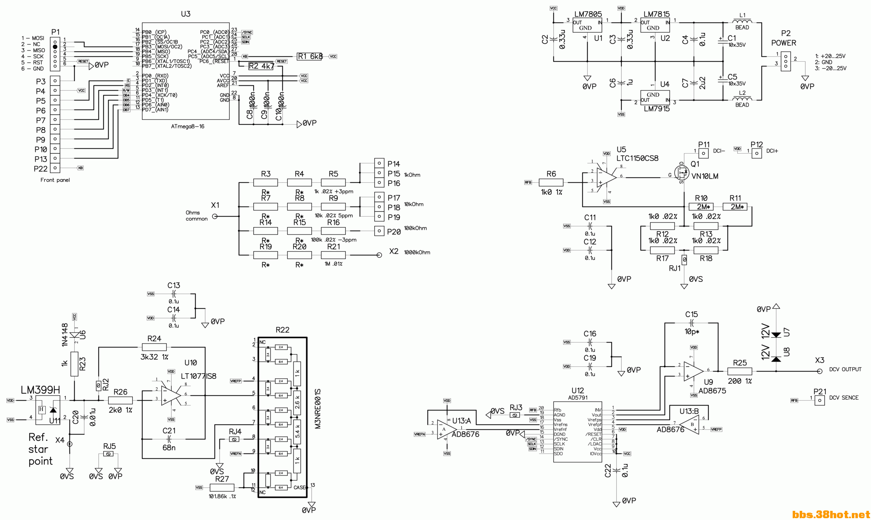

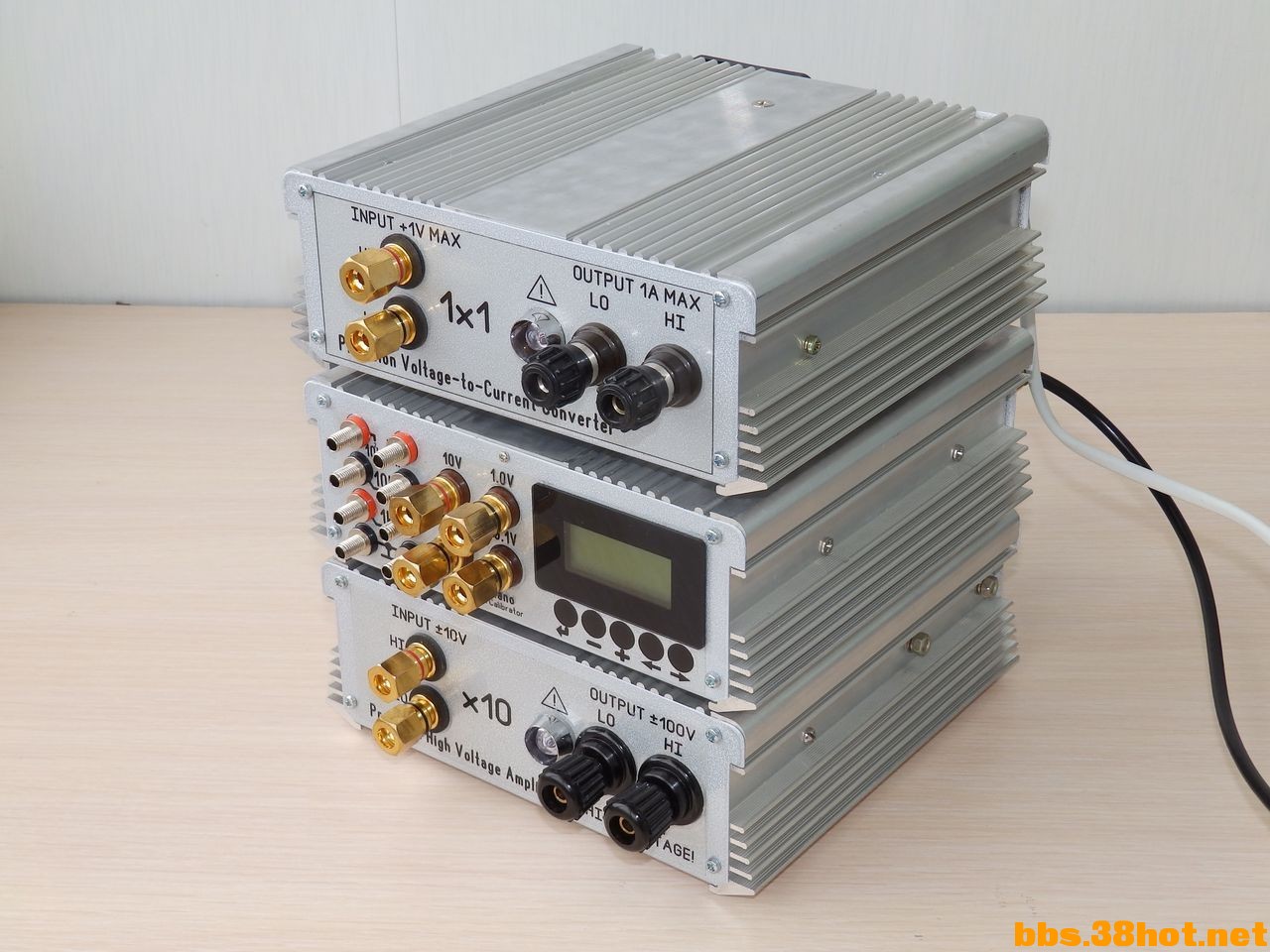

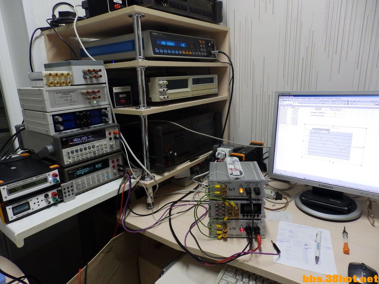

Multifunction Calibrator Based at The ON DIY AD5791B..
DCV 0.1, 1, 10, 100 V. The
the DCI mA 10, 1 A.
Ohms Operating Temperature Range (Fixed) 1K, 10K, of 100k, 1M.

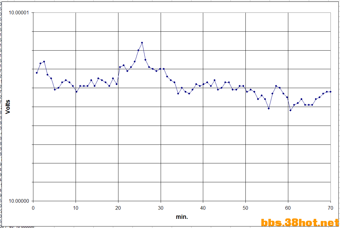

LF Noise (0,1-10 Hz): 2.2 ... 2.8 uV pp (10V / 10V ), 0.4 uV pp (0V / 10V).

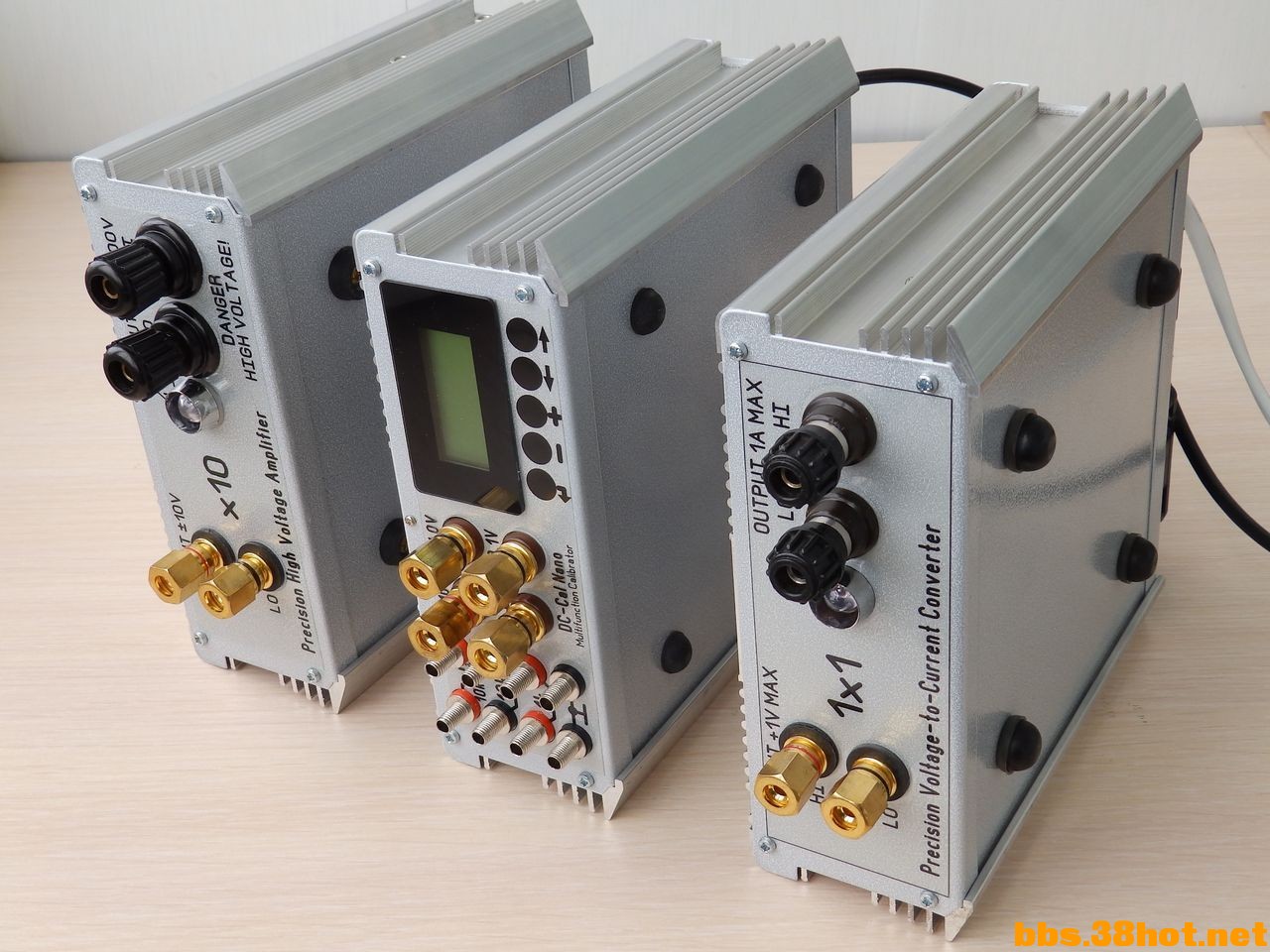

欣赏这种工艺,水平无论是制作还是技术,都给你一百个赞。

外壳挺不错的

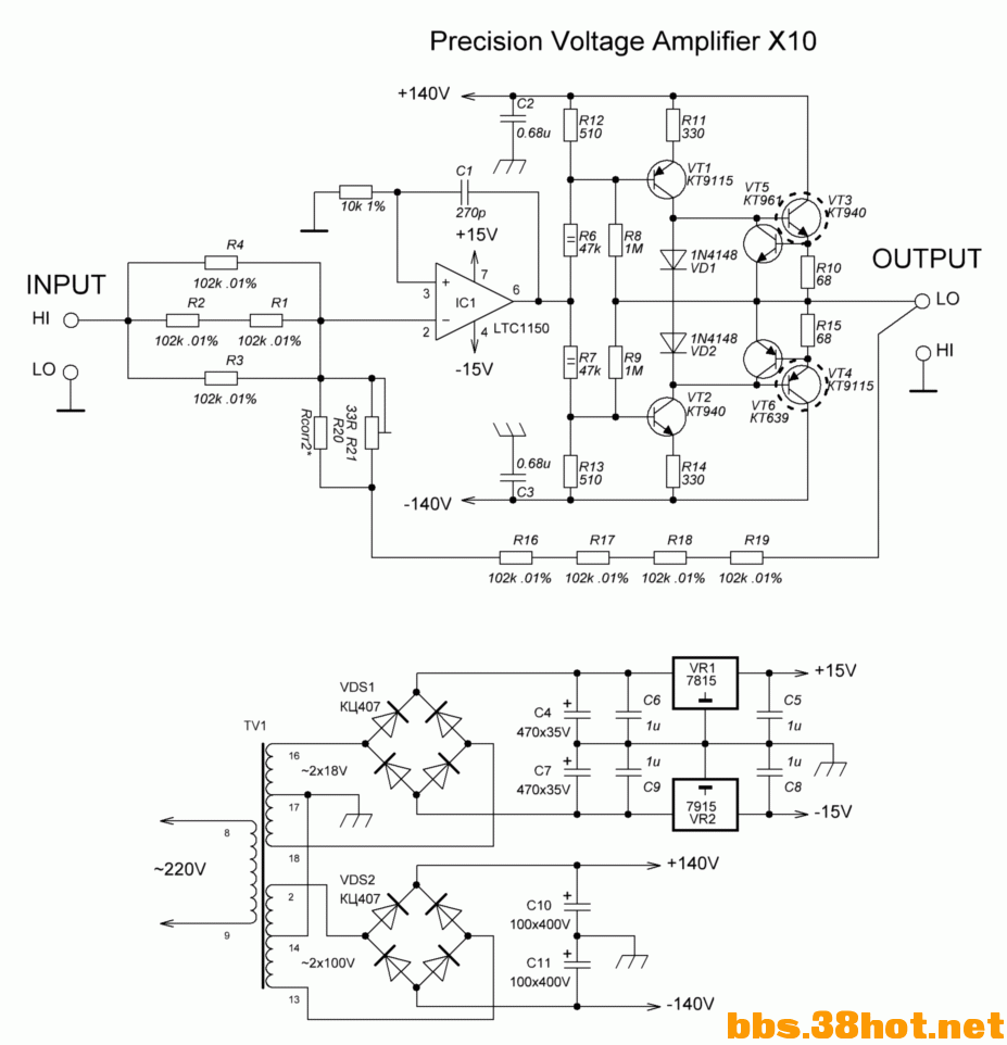

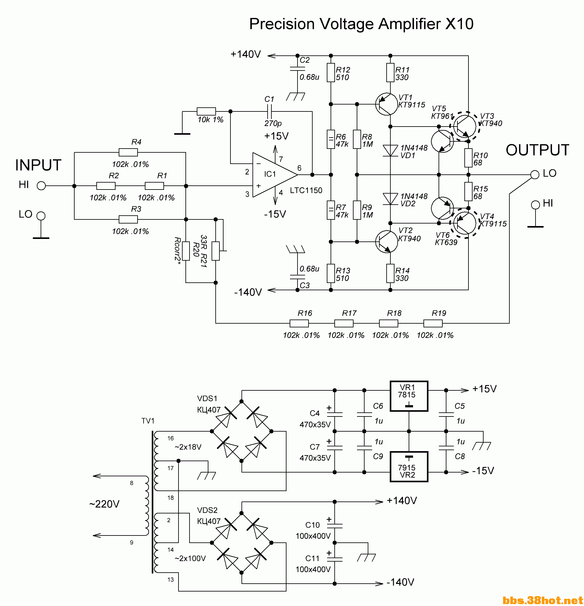

Your "Voltage Amplifier X10" LTC1150's pin 2 and pin 3 should swap?
I think that the input signal should connect to LTC1150's '+'  because the BJTs compose a inverting amplifier.
 楼主| 发表于 2016-8-4 17:16:13 | 显示全部楼层
It's my mistake. PCB is correct.

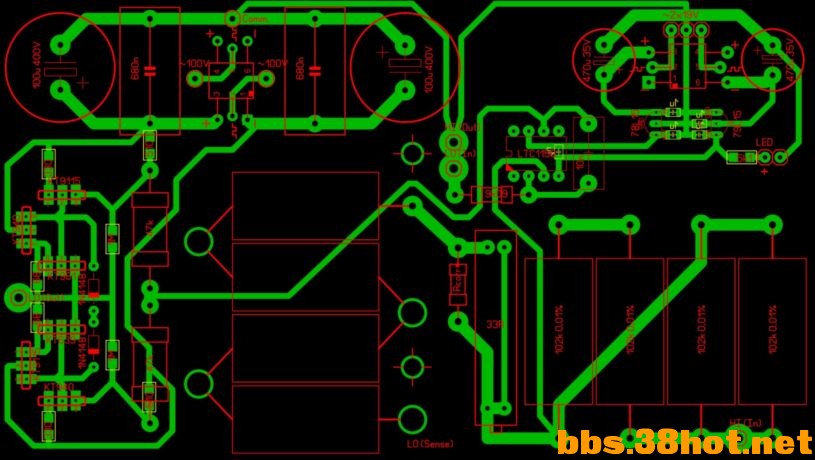

貌似电流和100V的输出都是开环状态?那如何精确控制输出数值呢

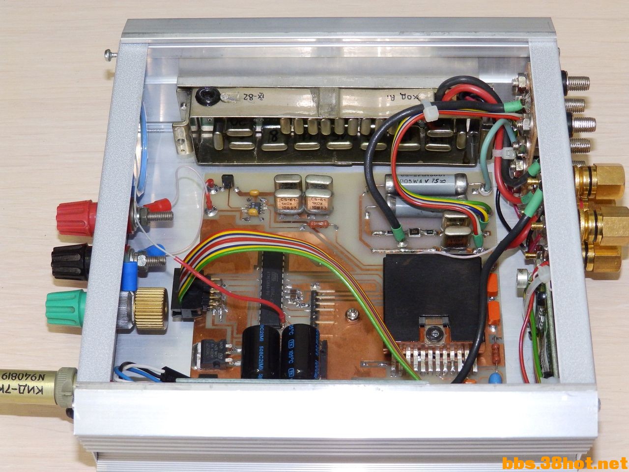

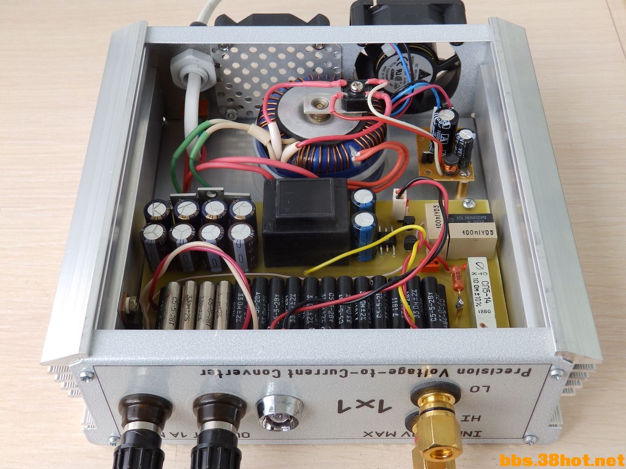

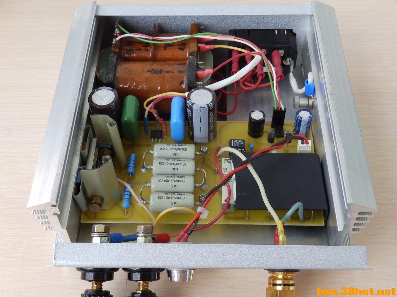

楼主的贴子,金封电阻一直是亮点

这么多金封电阻 ,厉害

开环精度靠元件稳定性。

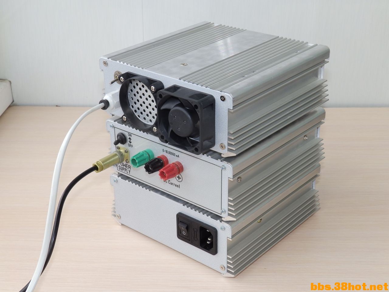

最有特点的就是那三个盒子。
