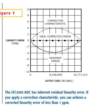

LTC2400是便宜,体积又小,不知道你说的软件处理一下就能到把INL从4PPM到0.8是哪篇应用,能否贴出来看看?
发表于 2009-11-9 00:40:10 | 显示全部楼层
7135我装过,换了好多积分电容,测试自己的基准最好的只显示9997,是两个聚笨乙烯电容,其它薄膜电容大多在9992到9996之间
发表于 2009-11-9 08:22:56 | 显示全部楼层
ADC SETS THE LINEARITY
The ADC’s linearity determines overall DAC linearity. The LTC2400 ADC has approximately 4 ppm nonlinearity. In applications for which this error is permissible,
you can ignore this error. Figure 7’s lower curve shows the ADC’s inherent nonlinearity, along with the firstorder correction you need (upper curve) to get nonlinearity
inside 1-ppm (center curve). If you need true 1-ppm performance, as in Figure 3, you can use software-based correction, which is part of the previously mentioned
comparator code.The software generates the desired “inverted bowl” correction characteristic. You can set the correction to complement the residual nonlinearity characteristics of any individual LTC2400 using DIP switches at the code comparator.
The LTC2410 offers another approach to improved linearity. This LTC2400 variant has improved linearity but specifies a maximum input range of 2.5V.
如果多斜率积分电路没有买不大的器件,为什么无法仿造出来呢?
