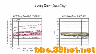

http://video.linear.com.cn/147
值得一看。

有趣的是,不同封装的ic对基准老化产生了方向性影响

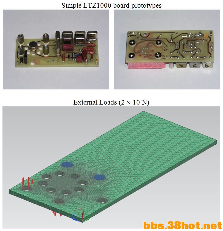

Simple LTZ1000 board prototypes with external loads (2 x 10 N)

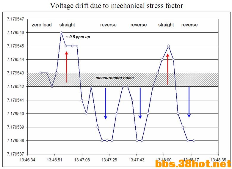

Voltage drift due to mechanical stress factor

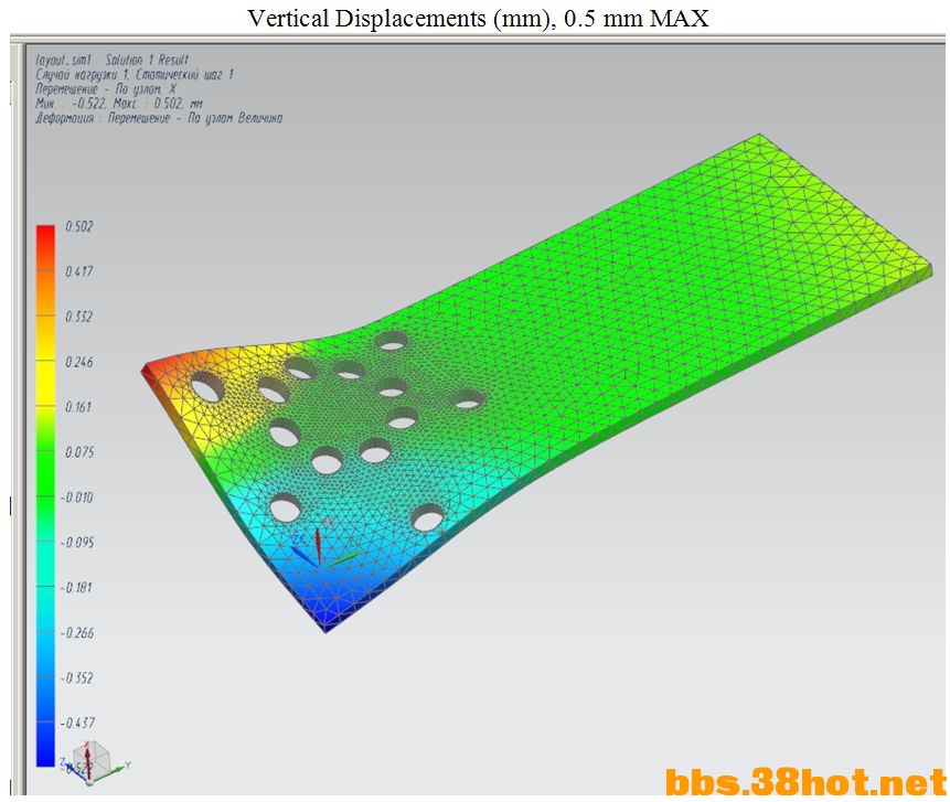

Vertical Displacements (mm), 0.5 mm MAX

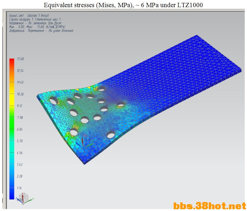

Equivalent stresses (Mises, MPa), ~ 6 MPa under LTZ1000

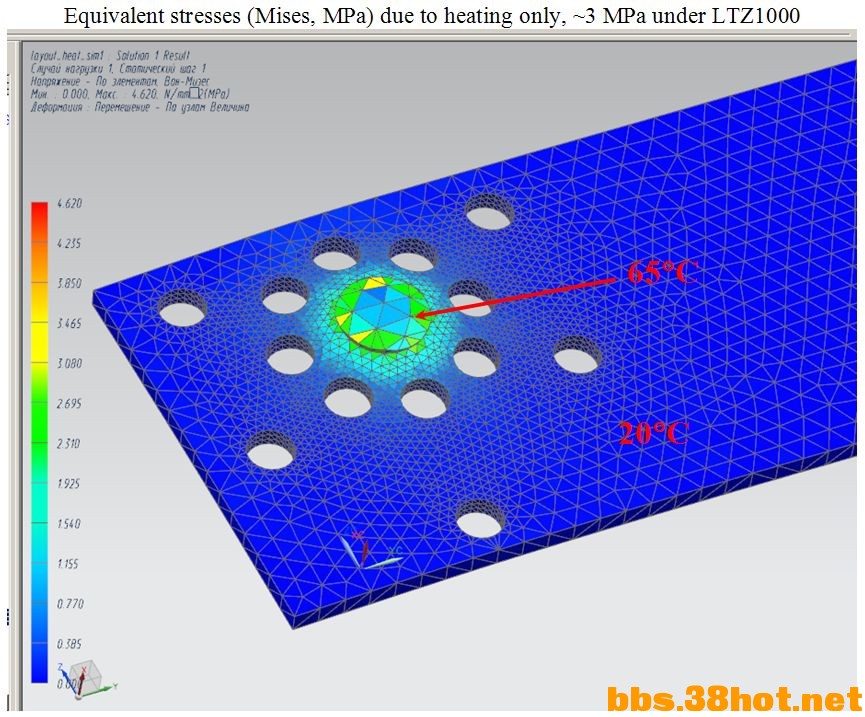

Equivalent stresses (Mises, MPa) due to heating only, ~3 MPa under LTZ1000
