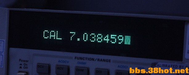

一直以为高位表的双基校准要10V和10K基准,手头没有10整数的,一直没动表,上周去HXYZ那里,他说可以用6-10V的电压校准的,回家看手册,原来HP3458是可以用1-12之间的任意值校准的:
For highest accuracy, the value sent with the CAL command must exactly
equal the actual output value of the adjustment source. It is recommended
that 10V be used for CAL 10 and 10 K ohms be used for CAL 10E3.
NOTE: Any standard value between 1 V and 12V or
1 K and 12 K can be used. A value less than 10V or less than 10 K
will introduce additional uncertainty to the multimeter's accuracy
specifications. For example, a 1 V DC standard can be used instead of
10V (you would execute CAL 1.0000). A 1 K standard can used instead
of 10 K (you would execute CAL 1E3). Each case degrades the
accuracy specifications of the instrument.

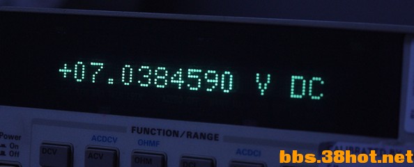

7.038459V基准去校准:
校准好了测量:
所以一定要养成勤看手册的习惯。
基于HP3458的超级线性,7V校准完全可以满足我的虚荣心了,估计,以后不会去做10V了,专心做好7V基准。当然这只是我个人的价值取向而已。

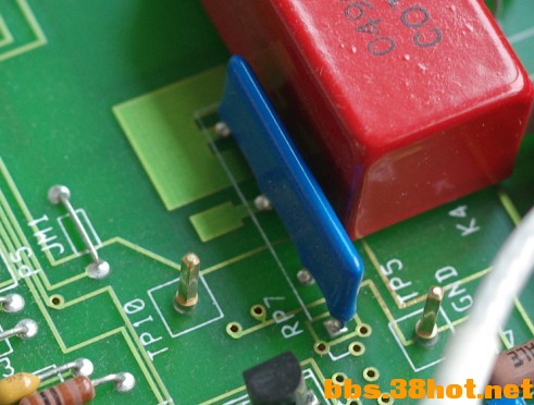

就这玩意,可能会让你大跌眼界,连特佛龙底座都没有,PCB漏电会导致零点严重漂移,潮湿天气自检还会爆自检失败,硬件错误。弄个内校准才会好。
3458就是靠着内校准来克服硬件上的随随便便。
