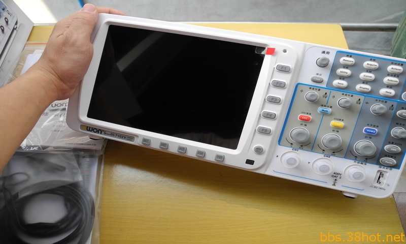

发表于 2013-3-8 12:05:41 | 显示全部楼层 |阅读模式

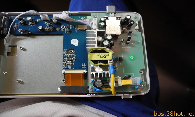

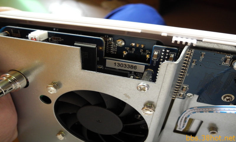

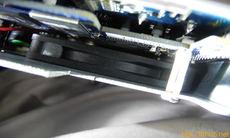

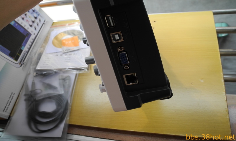

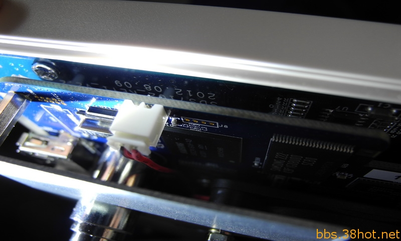

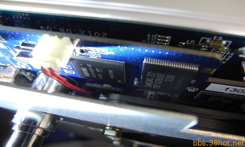

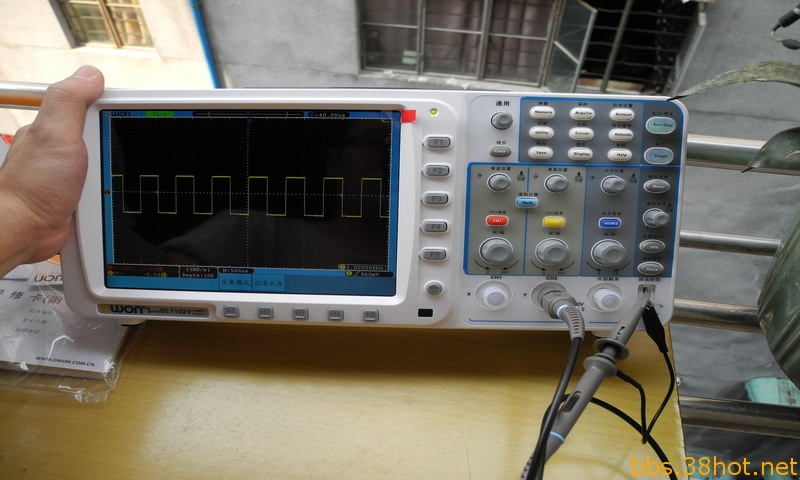

刚刚到货,批次是2013年3月的,拆出来拍拍图,下午拿去改7.4V电池。 厂家改进了很多,比以前的图片好很多了,电源部份不山寨了。在阳台强光下看得很清楚。
DSCN0240_缩小大小.jpg DSCN0241_缩小大小.jpg DSCN0242_缩小大小.jpg DSCN0243_缩小大小.jpg DSCN0244_缩小大小.jpg DSCN0245_缩小大小.jpg DSCN0246_缩小大小.jpg DSCN0247_缩小大小.jpg DSCN0248_缩小大小.jpg DSCN0249_缩小大小.jpg DSCN0250_缩小大小.jpg

这篇文章是老外写的:
关于带宽、噪声以及和Tek的波形比较等,个人觉得不错
关于ADC:
About ADC
SDS7102 have max samplerate 1Gs/s realtime (one channel) and 2 x 500Ms/s simultaneous for two channel.
ADC construction principle is most good what I have seen in this price class oscilloscope. Better than Hantek solution.
Owon use single chip ADC what is directly made for this speed!
(hantek use several 100MHz ADC's interleaved)
Owon ADC Chip is MXT2002 (RuiFeng China)
MXT2002 is National ADC08D500 clone. (exept case. ADC:128pin, MXT:144pin))
Some specs are slightly reduced but in my opinion not markable in this scope aplication and frequency range.
Non DES
ENOB 100MHz National typical 7.5 and clone 7.4
SNR 100MHz typical 47dB and clone 46dB
If go higher frequencies as example >200MHz then littlebit more differencies so than original win.
My opinion is: in this application differencies are not meaningfull.
National original chip is markable more expensive. (you can buy manyclone chips with one original chip price - but in critical aplicationsthese small differencies may be just enough)
Here is RuiFeng datasheet (not much text becouse can use national datasheet)
Note, you need support for chinese language, if want look all)
This ADC support directly 1Gs/s or 2x500Ms/s capturing.
Just simple change chip mode selection.
In this mode these two ADC's are internally interlieved with same clock.
This is very reliable and better way to do oscilloscope ADC than whatexample Rigol, Hantek, Atten, Siglent, GW etc. have used. ButHantek/Tekway and others basic design is old. They use same principle asRigol (etc). Several low speed ADC interleaved. Problem is timing andleveling these separate ADC's so it need lot of care that there do notrise any bad efects with timing jitter and level unbalance and otherunformity between ADC's.
This OWON solution is nearly free from these problems.
And also, this smart ADC have its own inside build low level calibration routine (it is not same as scope self calibration).
ADC is clocked with 500MHz clock and it need only one Clock source.
This clock generator is:
Analog Devices ADF4360-7 Integrated Synthesizer and VCO (350-1800MHz)
Clock reference is 10MHz.

发表于 2013-3-8 13:16:18 | 显示全部楼层
屏挺大的,但是面板设计觉得有点怪。

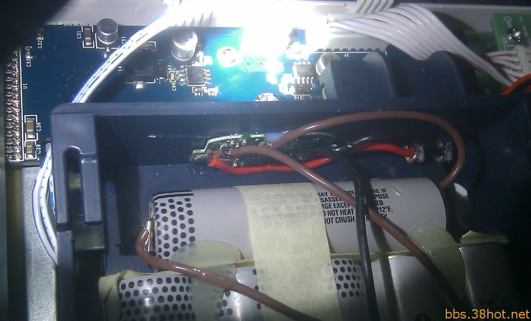

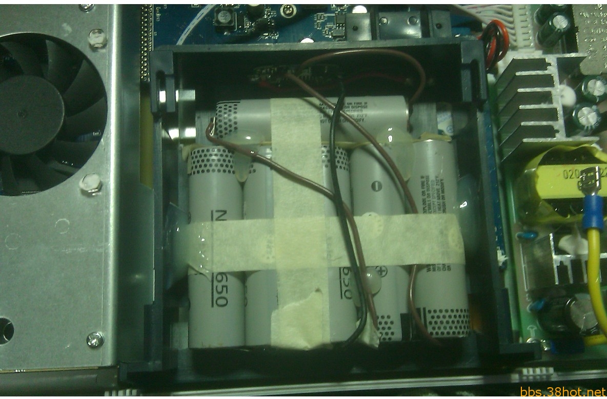

 楼主| 发表于 2013-3-8 20:50:59 | 显示全部楼层
 楼主| 发表于 2013-3-8 20:53:12 | 显示全部楼层
回 jimy0238 的帖子
jimy0238: (2013-03-08  20:50)
刚刚改装了6节18650电池, 3并, 再2段串起来,找了一个输出3A的保护板,能平衡充。 哈哈。正在测试
发表于 2013-3-8 23:19:42 | 显示全部楼层
关注电池测试结果
 楼主| 发表于 2013-3-9 22:48:17 | 显示全部楼层
电池改装实测,60%背光,4个半小时。

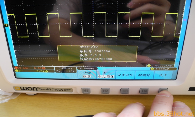

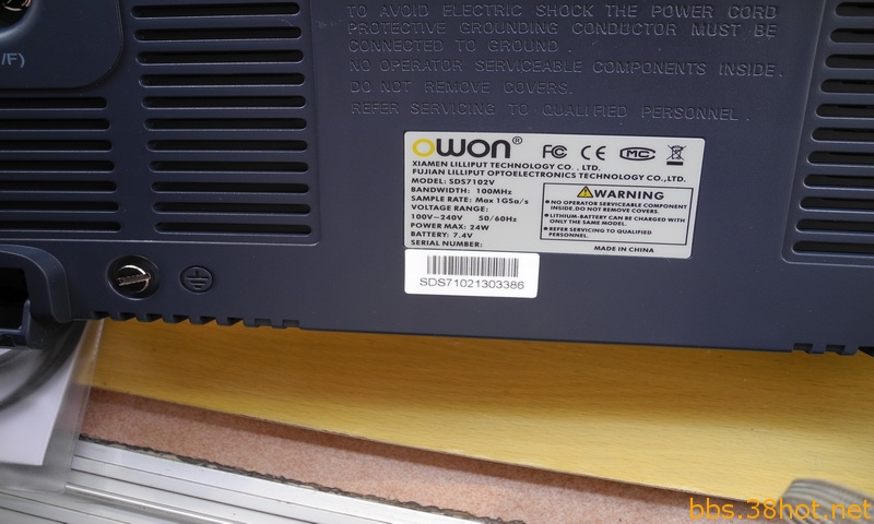

回 radioham 的帖子
radioham:系列号是什么?owon太不严谨来吧 (2013-03-16  10:04)
"序列号:, 估计写代码的人是用拼音输入法
