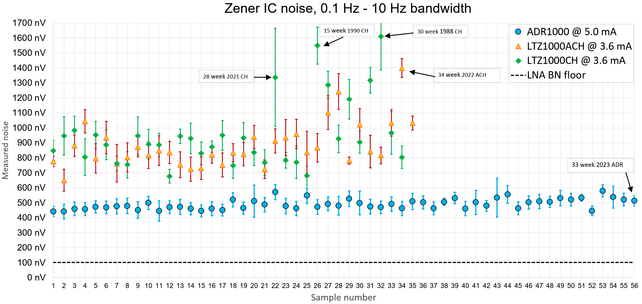

Some years back in 2019 I wanted to experiment with lowering noise on DC zener reference. Best commercial reference - LTZ1000A has ~1uV noise peak to peak 0.1 - 10 Hz. This is only ok for 7 digit, but not 8 digit.
Because we don't have lower noise and better stability DC reference without quantum standard - we don't have 9.5-digit DMM in 2024. But what is one combine multiple LTZ1000 together into averaged output? If we take 4 chip noise should reduce by SQRT(4) = 2x times.
So we should see 0.5 noise pk-pk. If we increase zener current from 5mA to 10mA we can further reduce noise. So I designed quad-zener reference board and here are some results and photos.
Later I also build same reference device but with new ADR1000 chips (500 nV noise pk-pk 5mA).

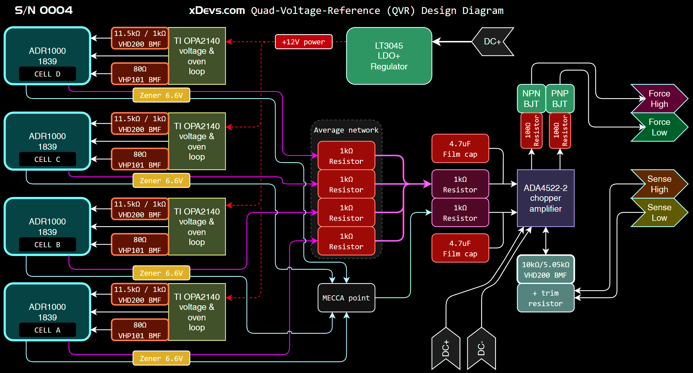

Each zener core cell is individual output, opamp, resistors, heaters. Only the power regulator input is same (LT3045 low noise +12V). This let me to use reference as 4 separate 7.1/6.6V outputs or combine with passive resistor network to averaged low-noise.
PCB is 6-layer RO4350 to reduce effects from humidity on SMT opamps (TI OPA2140) and SMT resistors/capacitors.
Assembly of all SMT parts done with reflow owen. LTZ chip and VHP resistor mount by hand with low temperature to avoid thermal stress.

And measured noise with 4 x LTZ1000A chip, 10 mA current, using 80dB enjoydiy amplifier 0.1 - 10 Hz:
250 nV peak to peak @ 7.1V , pretty good :). xDevs.com QVR consume about 160mA @ +13V and 5mA @ -13V for power.
I also tested many more ADR1000 and LTZ1000 chips (125 pcs total). ADR1000 noise is very good, usually about 450-500 nV pk-pk.

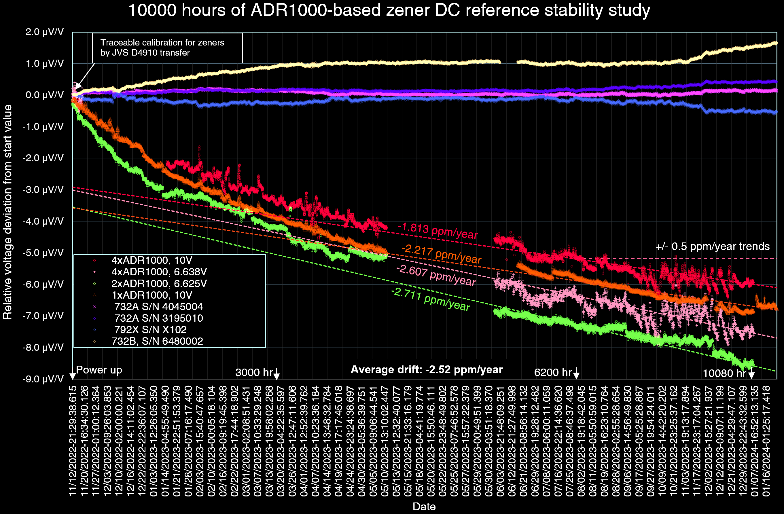

Three QVR module (4 ADR, 2 ADR and 1 ADR) are tested for long-term drift with nV-meter and DataProof 160A scanner. Drift compared to calibrated and stable Fluke 732A and LTZ1000A xDevs.com FX units.
ADR1000 show drift about -2 ppm/year when running at lower +50 °C oven. No special aging or preconditioning was done before assembly.

And final block diagram..
Hope for good results in 2025...
