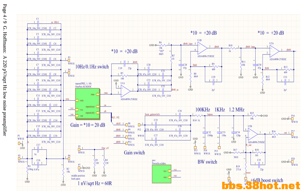

一个低噪声放大器图
发表于 2016-5-11 17:54:17 | 显示全部楼层 |阅读模式
pdf大于2MB了,我用7zip压缩成分卷文件,可论坛不允许.001这样的扩展名,我就把序号往前挪了一下。没想到各位都不能解压了。我不会弄论坛能接受的分卷啊。只好附件先删除吧
还好7楼贴出了源文件地址

发表于 2016-5-17 18:51:10 | 显示全部楼层
请各位注意,此原理图已经被多人指出设计不周,有原理性错误。
http://www.eevblog.com/forum/pro ... se-measurements/25/
However I believe his amplifier to be seriously flawed – I calculated that the noise voltage generated by the current noise flowing through the 10k//160uF input filter will be around 45nV rms/sqrt(Hz) at 1Hz rising to 800nV at .1Hz!
然而,我确信,他的放大器有严重缺陷 。。。。。
Note that his article has a chart showing the very respectable noise floor with the amplifier input grounded; however the short is applied after his 160uF, 10kohm DC blocking filter so only the voltage noise is shown.
他测量本底噪声的时候,没有从外部输入进行短接,而是从内部、越过输入电容进行短接的,这样就没有显示出运放电流噪声在那个小电容上的噪声压降。。。
ADA4898这种运放,低频噪声很大,尤其是低频电流噪声非常大,做出的放大器只适合较高频率下的噪声测量,不适合诸如基准测试的那种0.1Hz到10Hz的频率范围。作者把测量频率下限拓展到0.1Hz,运放是无能为力的,测量得到的结果是严重偏离实际的。
