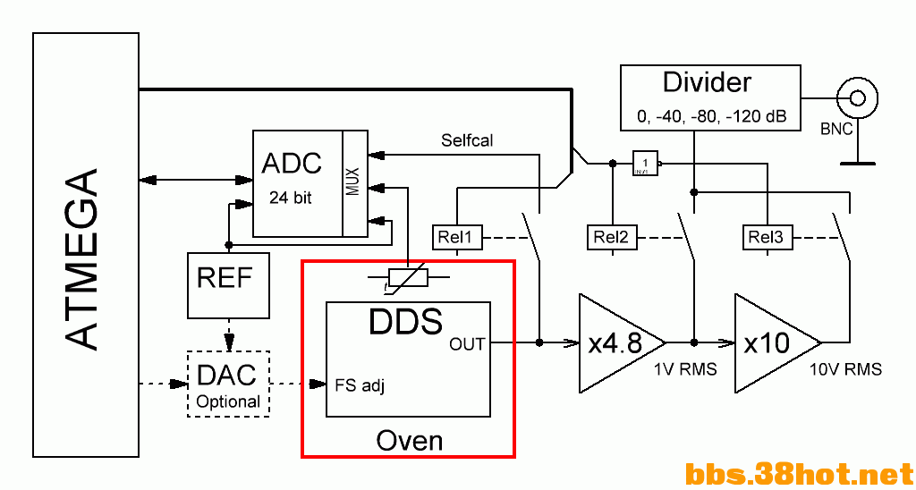

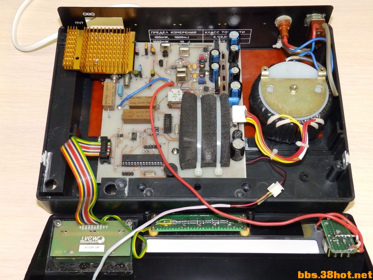

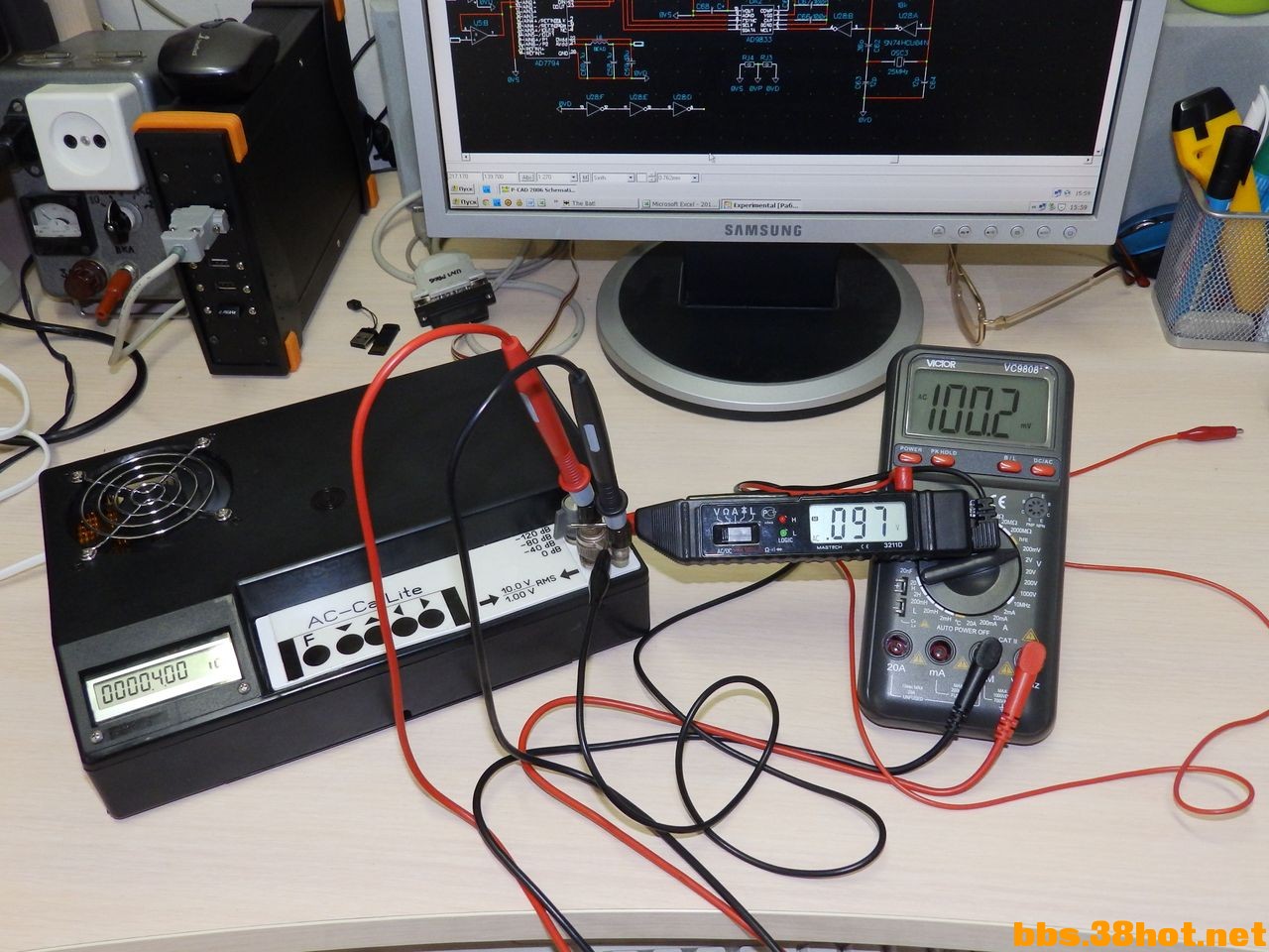

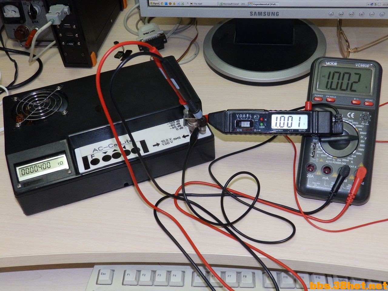

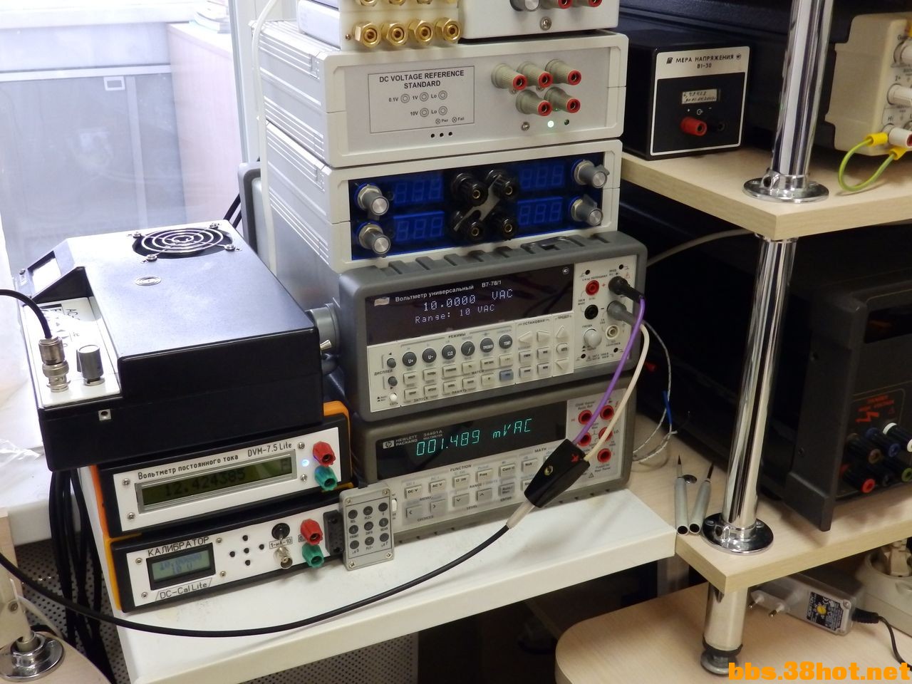

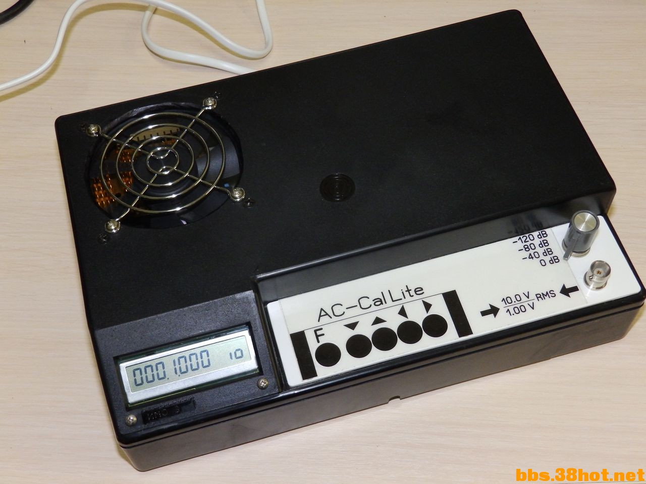

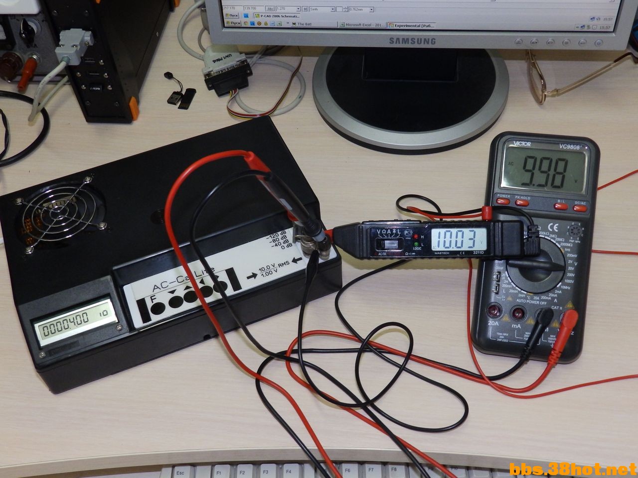

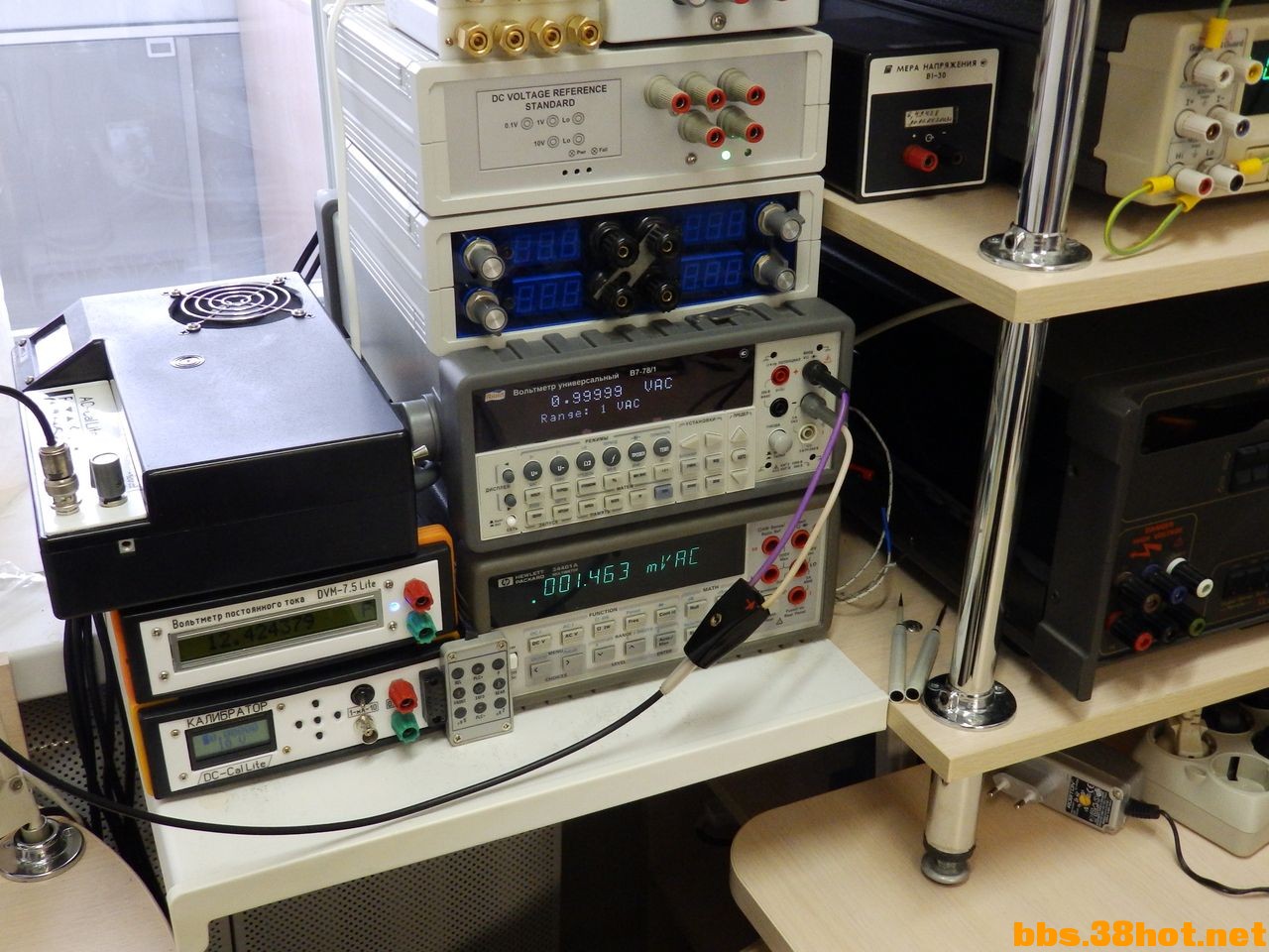

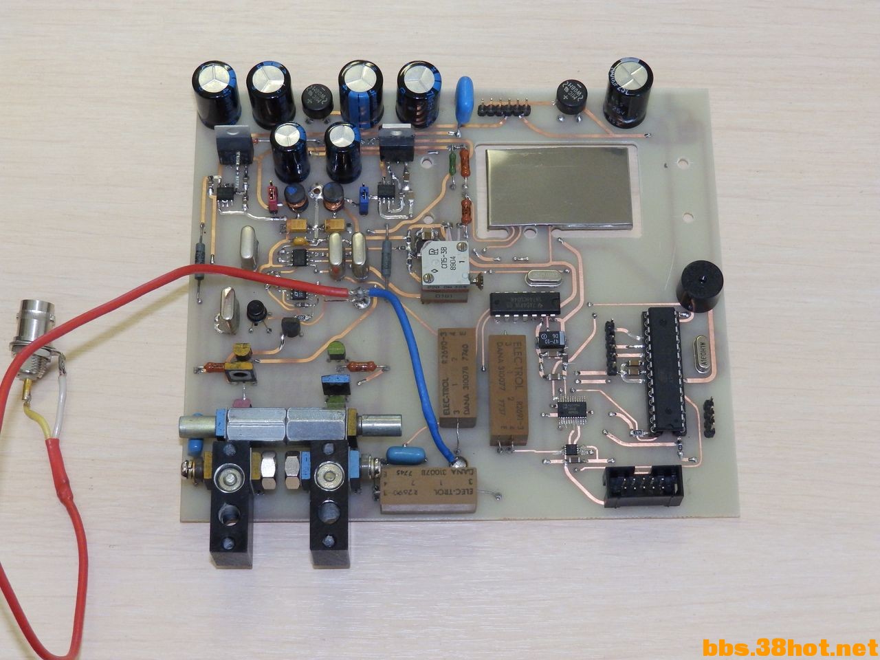

1 uV - 10 V RMS voltage output.
100 Hz - 1 MHz frequency range.
Diagrams.pdf
153.8 KB, 下载次数: 261

1、how to adjust the output sine amplitude?
2、how to transmit(convert) the sine voltage to dc voltage?

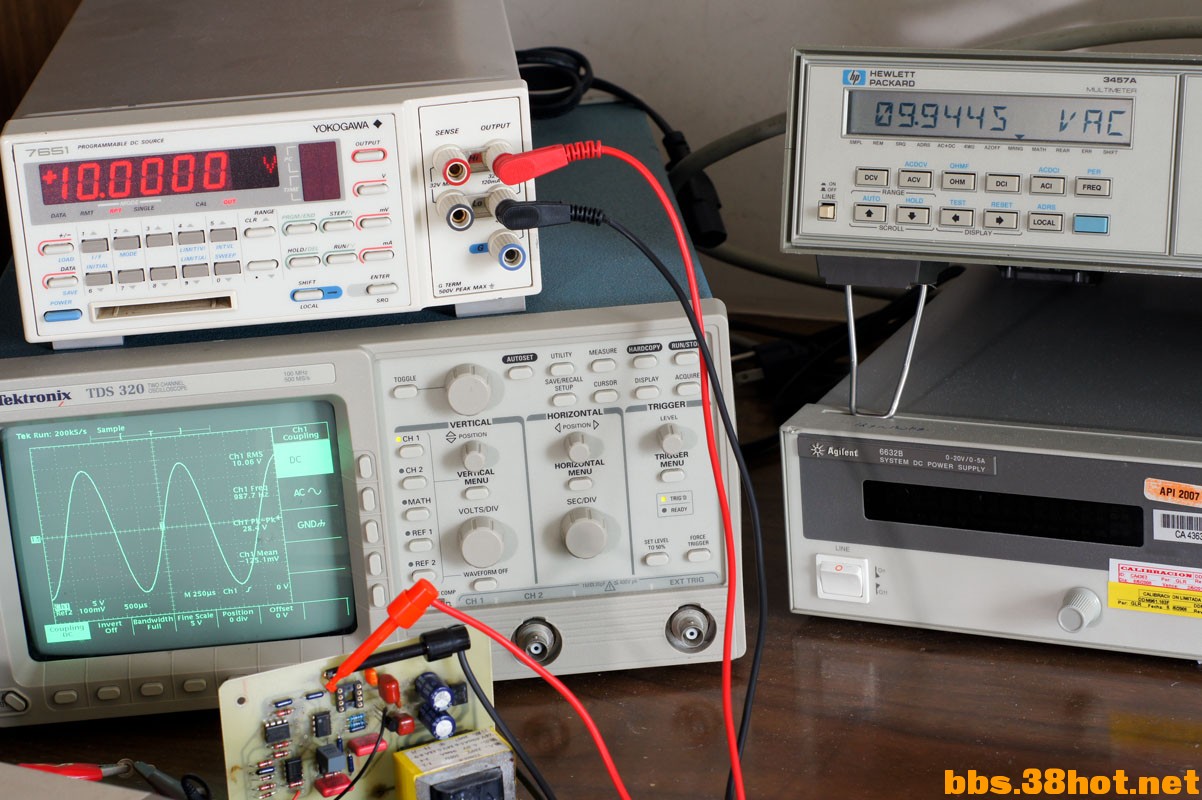

NTC compared with PN juntion, which one will be more precise for oven? I'm working on a simple oven using 10K NTC, SCH was  referenced from a TCXO.
发表于 2016-3-19 20:09:53 | 显示全部楼层
Can you tell us:
How to achieve closed-loop control, how to achieve a stable AC to DC conversion
发表于 2016-3-19 20:36:36 | 显示全部楼层

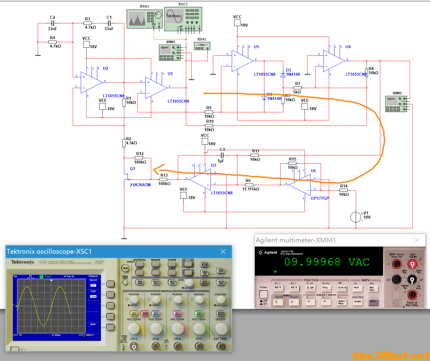

My fixed frequency closeloop sineware source, output AC voltage calibrate to the DC Voltage reference(V1)

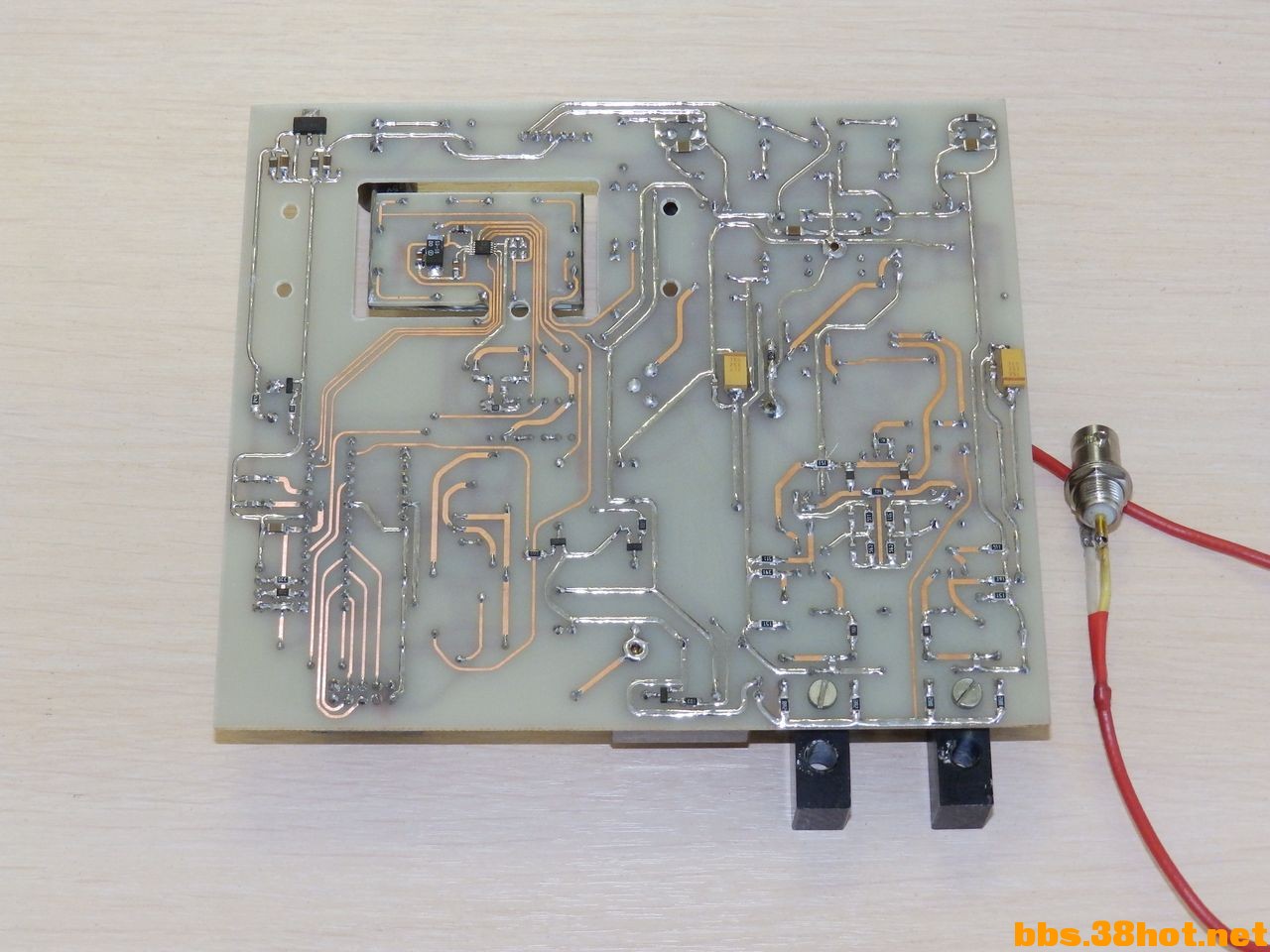

 楼主| 发表于 2016-3-19 22:21:47 | 显示全部楼层
2、how to transmit(convert) the sine voltage to dc volt ...
1. This is the "lite" version without the amplitude adjustment.
2. This is the well-known calculable type of voltage reference.

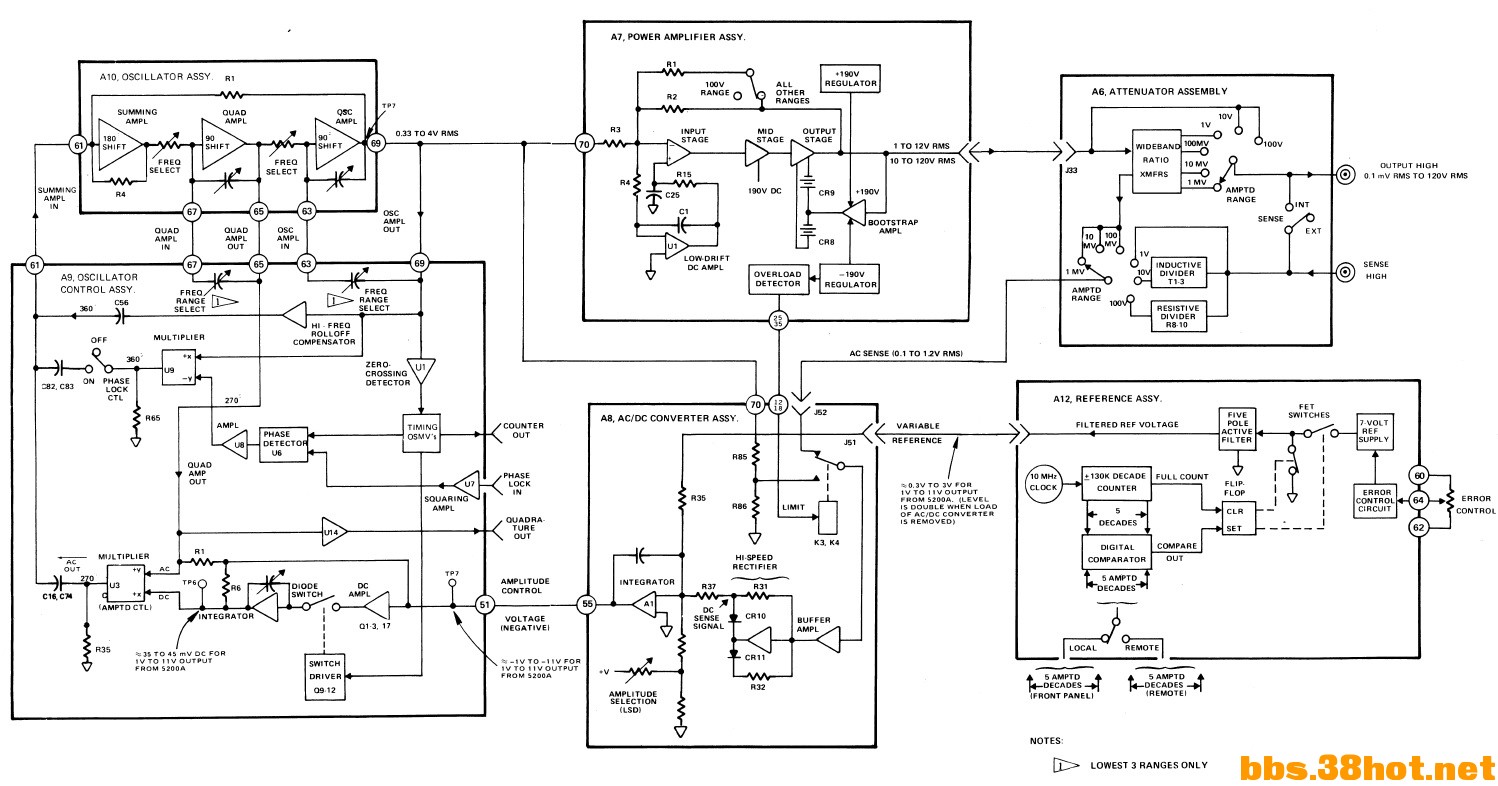

Digitally Generated AC Reference Source
The Solutions: Calculable AC Voltage Reference
Guildline Model 7410 AC Voltage Reference
发表于 2016-3-20 18:05:18 | 显示全部楼层
2. This is the well-known calcula ...
I konw you mean,but its not a AC self-calibration source,because
1、the calibration point is not at amplifier(1V/10V) output, the error introduced by amp(temperature,frequency,and so on ) could not be corrected.
2、the AC Voltage isnot building a close-loop by your DC Standard, its open loop. I think the self-calibration is a close loop design?

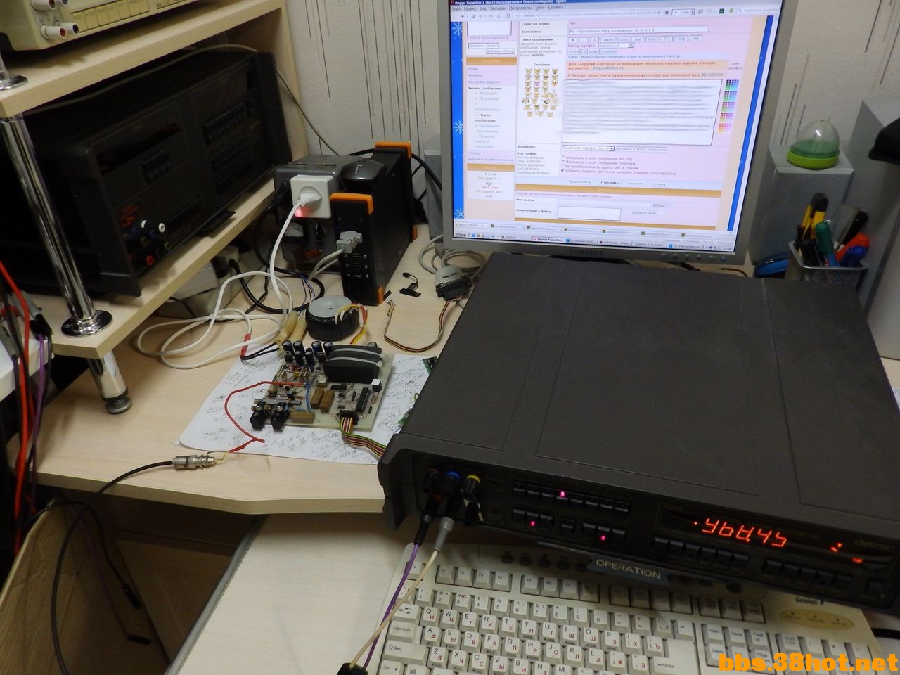

 楼主| 发表于 2016-3-20 21:19:19 | 显示全部楼层
It's a simple prototype board, made over the weekend. The full one is mach more complex.
 楼主| 发表于 2016-3-20 21:19:35 | 显示全部楼层
