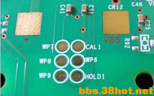

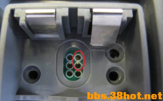

Enter calibration mode
1.     Take off battery door and battery, batteryspring connect to 3V power supply;
2.     Turn RSOB to select the function to becalibrated;
3.     Short circuit ‘CAL1’ and ‘WP6’ pad on PCB bottomonce;

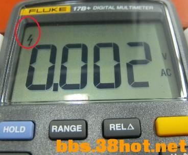

LCD display pictures afterentering every function
VAC function, High voltagemark flicker
VDC function clip_image003.jpg ,High voltage mark flicker
去掉电池仓和电池,外接3v电压源,
短接cal和w6 结点,进入校准模式
接入合适的校准源如F5522A,输入当然还是从表笔那里进入,
校准模式下输入校准值,(这个没说怎么输入),
按住hold健完成校准,每个单元都要校准一遍,
17B+温度校准,需要手动调档位
完成所有校准后 turn off 关机
