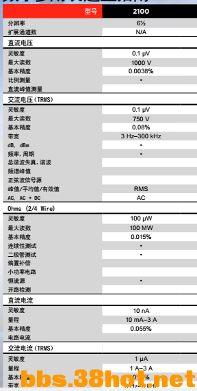

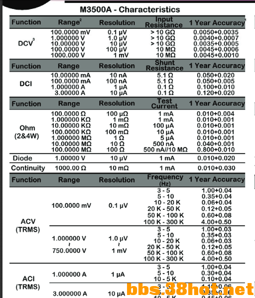

keithley2100和仪鼎M3500指标对比
发表于 2015-8-24 17:27:37 | 显示全部楼层 |阅读模式
同一个表,keithley和仪鼎给出的指标,不评论什么,看看就好

发表于 2015-8-25 08:24:32 | 显示全部楼层
仪鼎的指标比吉时利的要好很多啊,怎么就。。。。。。。。。。
发表于 2015-8-25 09:31:15 | 显示全部楼层
国产表的指标也很高啊,怎么就。。。。。。。。。。

Keithley 2100 = OEM PICOTEST M3500A
PICOTEST M3500A = modified Keithley 2000
发表于 2015-8-25 19:31:05 | 显示全部楼层
〆﹏熋訷悪鎩, look to the 2100 Service Manual ! M3500A schematics is based on the Keithley 2000.
My topic: http://radiokot.ru/forum/viewtopic.php?f=10&t=103615
发表于 2015-8-25 21:53:41 | 显示全部楼层
My ...
The 2100 6.5 digital DMM without any Service Manual  pico test may have one
As you said it's similar or base on keithley 2000,if thats true, It needn't adjustment the input R by the system manuul,the keithley 2000 auto  adjustment the input R by the DC voltage range 100mV 1V 10v for 70Gohm input R and 9.9Mohm±1% for the 100V and 1000V range
Adjustment the input R by the system manuul is agilent stlye not the keithley's
I worked in keithley Service department for 5 years and quite sure about that
