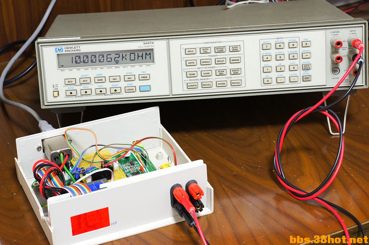

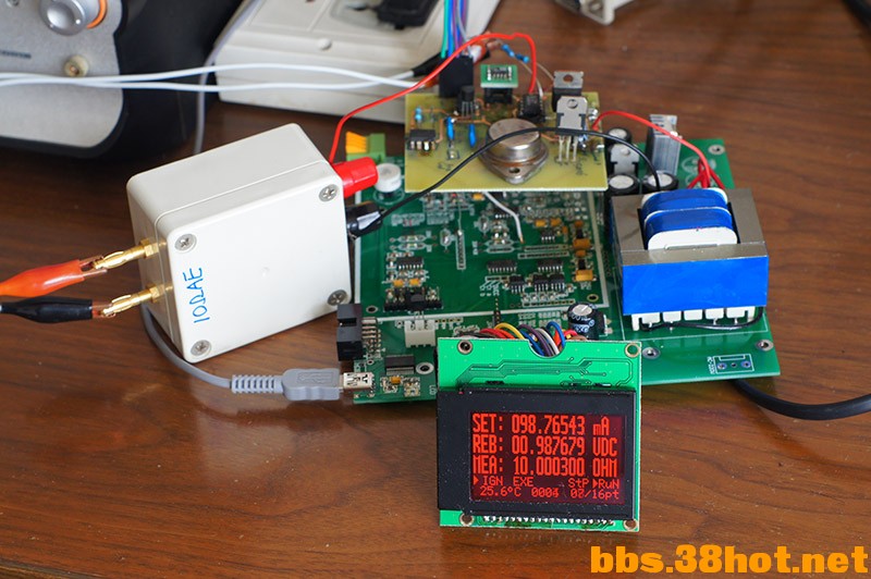

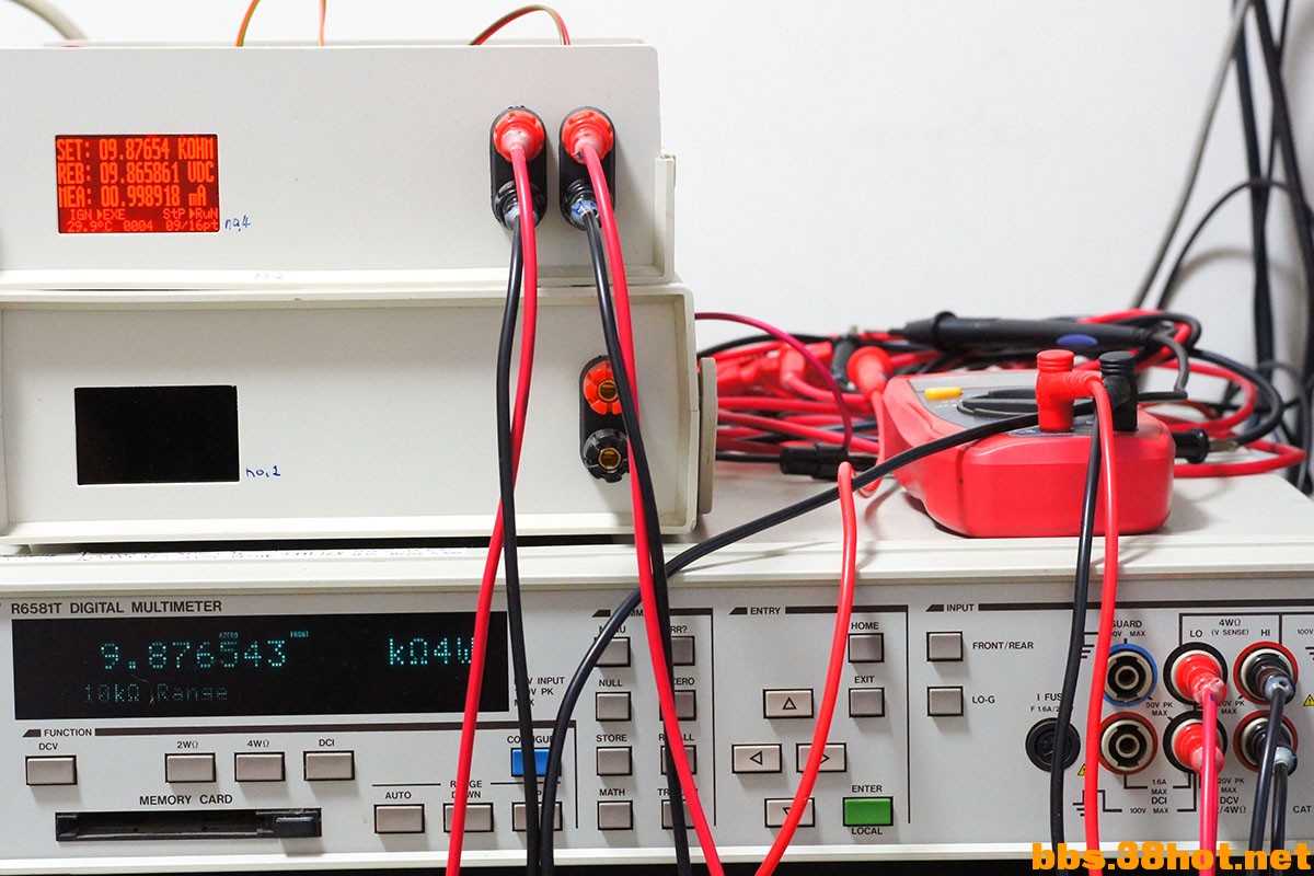

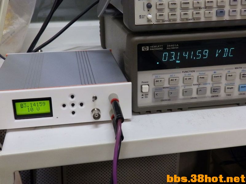

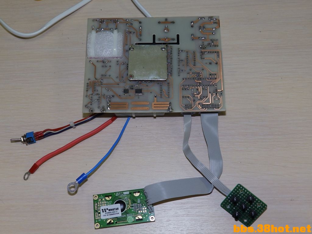

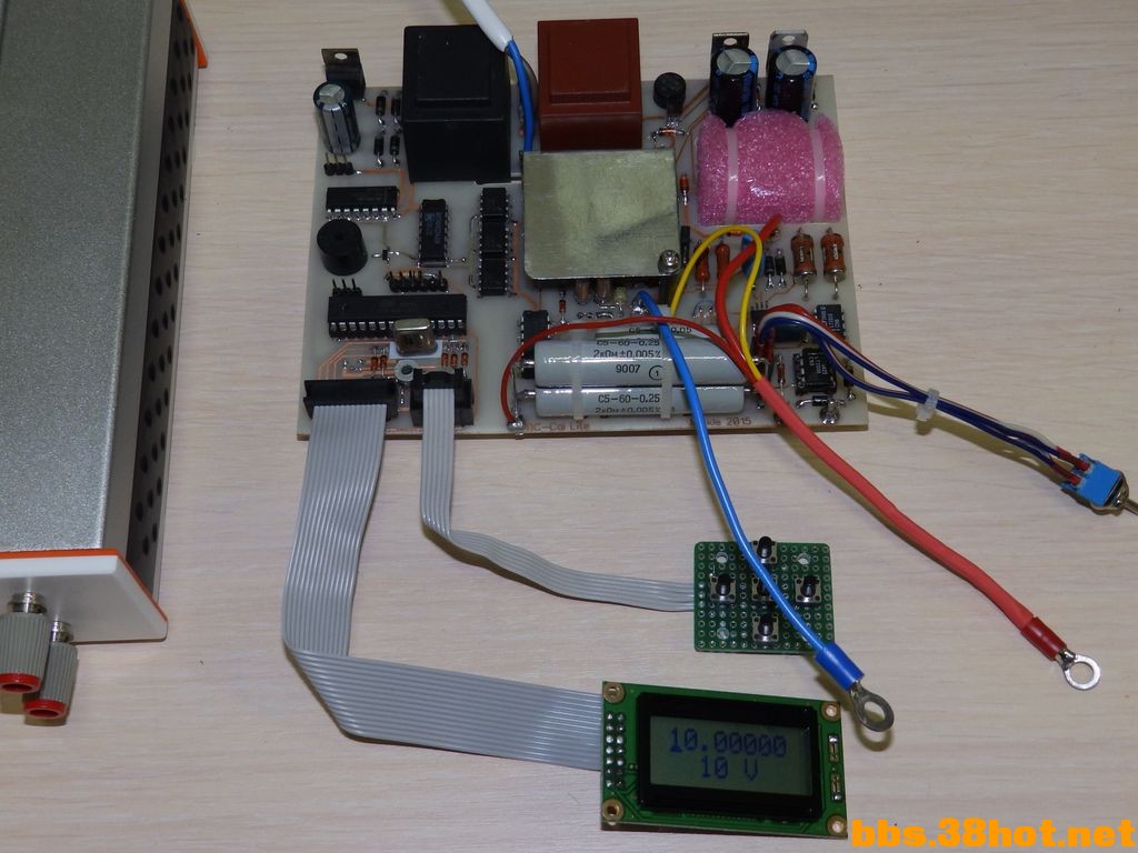

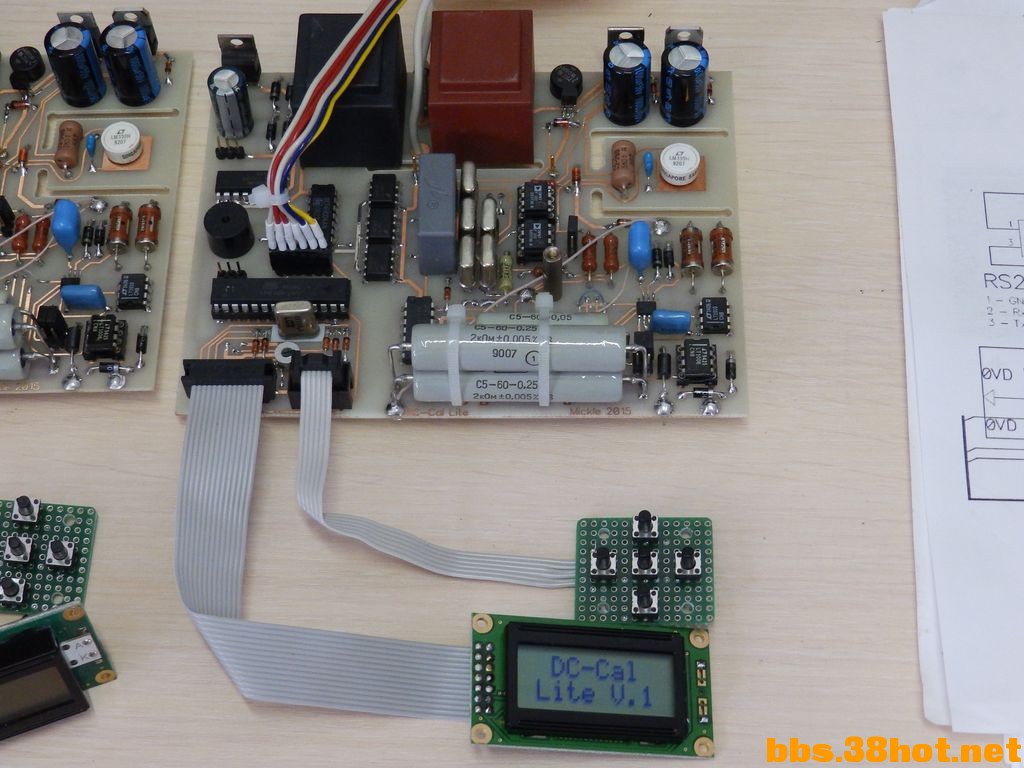

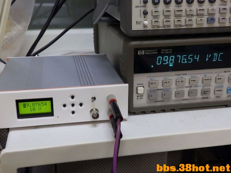

0-10V, 0-1 mA, 0-10 mA, 1 kOhm 0.005%, 0.005% 10 kOhm.
Noise (0.1 to 10 Hz) 4 UV pp

太牛了!基准是看着是lm399。
发表于 2015-8-19 08:46:13 38hot手机频道 | 显示全部楼层
等原理图,液晶是12232?

发表于 2015-8-19 13:14:09 | 显示全部楼层
Pls share the diagram and special components...
LM399A Voltage Reference and  a lot of low TCR resistors, the resistors made from Russia?
What's type of ADC and DACs, buffered or not? unprecedented close-ups of them...

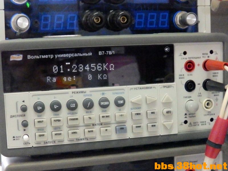

发表于 2015-8-19 16:52:41 | 显示全部楼层
是模拟电阻吗?

You can measuring a micro resistance when you designed the current source
 楼主| 发表于 2015-8-20 13:55:00 | 显示全部楼层
