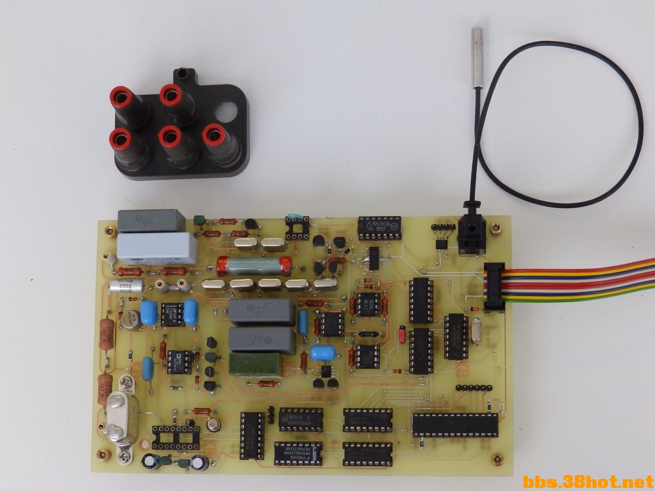

-0.1 ... + 14 V input.
8.5 digits - 10 sec.

怎么没有看到显示啊?

金封很便宜?看到有7个!

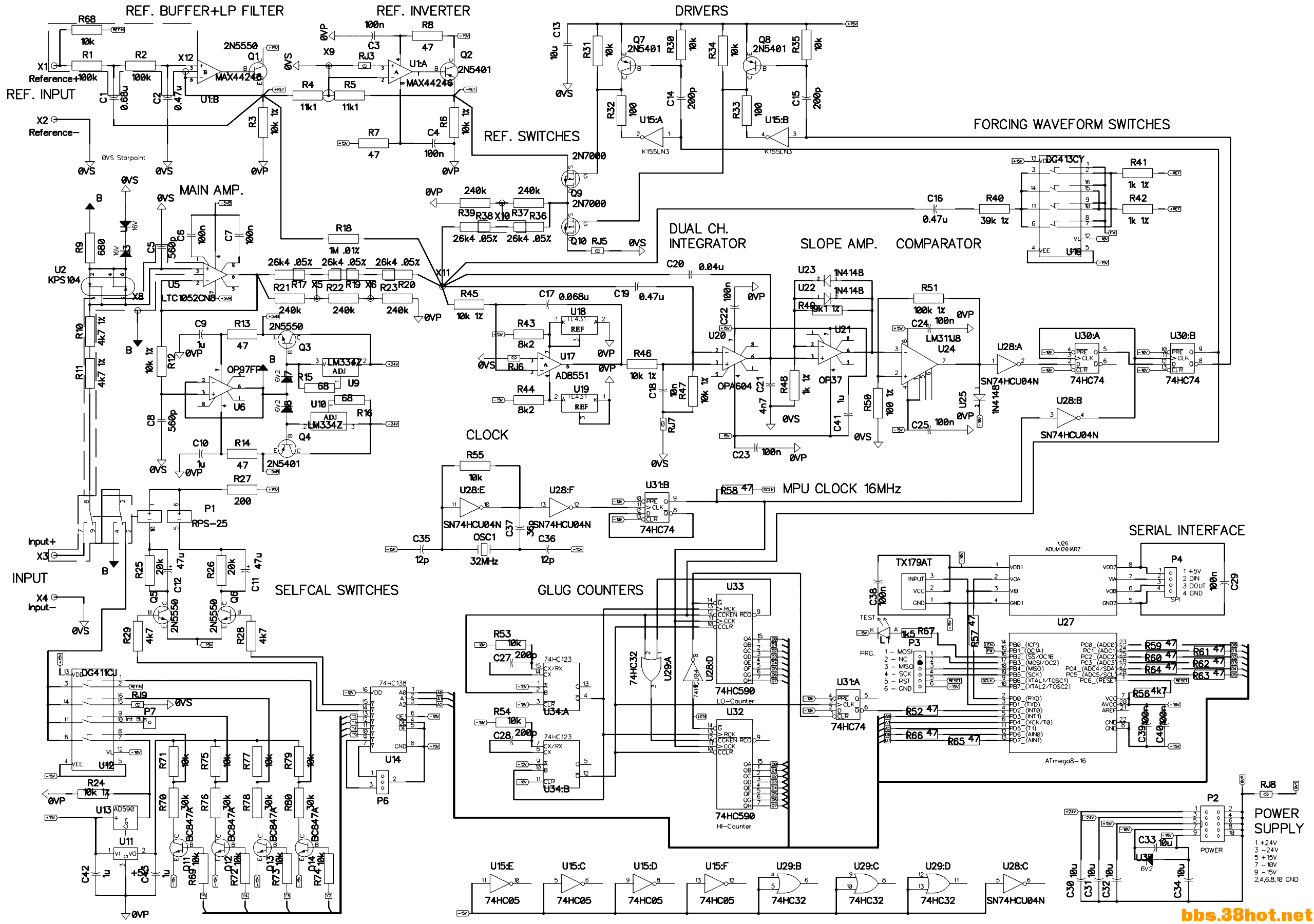

May I take a view of this board's schematic?

对ADC部分比较好奇

右上方的那个是光纤接口吗?是用来传输控制信号的吗?

Very good,can you provide the schmatic to reference
iddqd2001
iddqd2001
发表于 2014-12-12 20:50:30
Currently only external voltage reference is used.

8位半了,ADC是多斜吗

ADC部分的原理能介绍一下吗?
Can you provide the schematic of the ADC part? Lots of diyers are interested in it.

Could you introduce your 8.5bit DMM to us?

继续顶贴,顶到adc原理出来为止。
