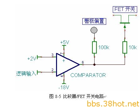

8-33.Fet Switching Technique.Thecomparators that bias the Fet switches on or off have open collector transistoroutputs.These outputs are connected via 100k ohm pull-up resistors to theoutput levels of either Gate Bias Amplifier #1 or #2,except for U104b and U104c(see Figure 8-5 Comparator/Fet-Switchcircuit).With the +2 volt reference applied to its negative input terminal,alow logic input signal will cause the comparator's output to be driven to -18Vand the Fet switch will be off(refer to Table 8-2).With a high logic inputsignal,the comparator's output transistor is turned off and its output willtherefore rise to the pull-up voltage level(usually the input signal level).TheN-channel Fet swtich will be closed with this pull-up voltage applied to itsgate.
8-34.The pull-up resistors forU104b and c are connected to ground,thus their outputs will rise to ground whenthey are turned off.Note that in some cases the +2 volt reference is applied tothe positive terminal.Comparator operation will then be exactly opposite ofthat just described.Table 8-2 lists all of the normal comparator inputlevels,comparator outputs,and resultant Fet switch state.The 10 k ohm resistorsconnected to the gates of the Fet switches along with the stray capacitance actas low pass filters to prevent pickup and rectification of stray AC signals.
翻译:
8-33.Fet开关技术:施加给Fet并使其打开或关闭的偏置电压,由具有开漏输出功能的比较器提供。比较器的输出通过一个100k的上拉电阻,然后连接到栅极偏置放大器#1#2的输出端(见图8-5)。比较器的反相端接+2V电压,当同相端输入的逻辑信号低于此电压时,比较器输出为-18V电压,Fet开关将会断开(参考表8-2);当同相端输入的逻辑信号高于+2V时,比较器内部的输出三极管为断开状态,所以比较器的输出为高阻,输出电压值为其上拉电压值(一般为Fet开关的输入信号的电压值);N-沟道的Fet开关在此电压驱动下将会导通。
8-34.连接到U104bU104c的上拉电阻式是接地的,所以当他们导通时,栅极驱动电压为0V。注意:在某些情况下,+2V的比较电压是接到比较器的同相端而不总是接到反相端,因此比较器的输出也是和之前描述的相反。表8-2列出了所有比较器输入电压,输出电压,Fet的断开、导通情况。Fet栅极接入一个10k电阻,其与杂散电容一起起到低通滤波器的作用,以阻止杂散的交流耦合信号。

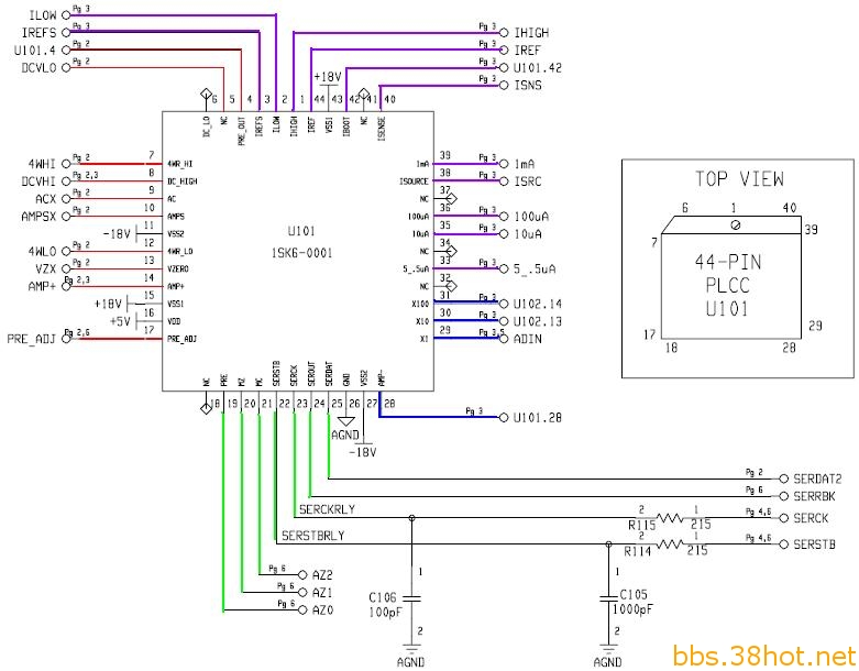

HP34401A模拟部分使用2块专用ICHP自行开发的芯片)U1011SK6-0001)和U1021NB4-5035)。U101是模拟开关阵列;U102是电阻网络。本节主要来分析U101内部的电路结构,并试图用分立元件来实现其功能。 P3.JPG
其中红色线为输入切换开关;蓝色线为量程切换(×1,×10,×100)开关;紫色线为电阻档恒流源量程切换(5.5uA10uA100uA1mA)开关;绿色线为数字控制线;未着色的黑色线为电源线或空脚。
AZ0AZ1AZ2分别为预充电(PRE),置零(MZ)和信号(MC)控制脚,由单片机直接控制。
电源为+18V-18V+5VAGND;共3组电源。±18V为内部模拟开关电路电源;+5V为逻辑电路电源。

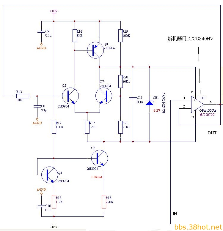

DC可编程增益放大电路包含一个工作点稳定的DC放大电路和增益切换电路。DC放大电路的设计要点就是:1.工作点稳定,即不同的输入电压下放大器的工作点尽可能不变;2.低噪音。对温漂等参数没有特殊要求,只要短时间内变化不明显即可(如200ms内没有明显变化),因为测量时是会将这些固定误差减去的。这样做的目的就是降低全量程的非线性误差。

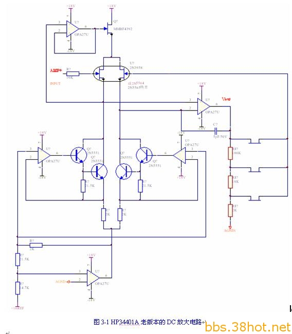

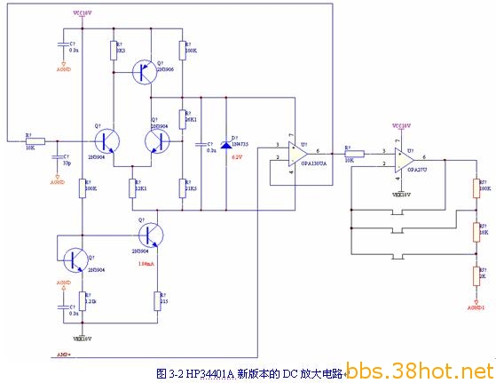

HP34401A的几个版本电路中可以发现这种设计思路。对比图3-1和图3-2,新版本的电路依然使用直流伺服电路,以确保工作点稳定;但放大器主体改为低偏置电流的集成运放芯片OPA130UAFET输入,最大偏置电流为20pA)。
可编程增益电路是通过选择电压的负反馈量来实现的,共有3个增益可选:×1, ×10, ×100。三个模拟开关用来选择不同的分压,然后反馈到DC放大电路的反相输入端。注意,在控制此处的3个模拟开关时,要先闭合再断开(make-before-break),以防止3个开关全断开时放大器的开环放大状态。3-1中,反馈电阻通过模拟开关接到FET的栅极,即反馈电路从反馈电阻上所取的电流是极小的(pA级),也就是反馈回路对分压电阻分压比的影响是非常小的。而图3-2中,反馈电阻通过模拟开关接到运放OPA27U的反相端,OPA27U是低噪精密运放,但其输入偏置电流最大为±80nA,失调电流最大为±75nA;这些误差均为固定误差,不随输入电压的大小而改变,或改变的值非常小,达到可以忽略的地步。
运放OPA130(或TL071C)加了伺服电路,目的是在不同的输入电压下保持输入偏置一致,这样的话,固定的输入偏置电压就可以被去除掉。

图3-2有问题吧,稳压管不应该钳位运放的电源,否则,运放不能正常工作
 楼主| 发表于 2012-4-1 17:36:01 | 显示全部楼层
To楼上:说话要负责任的哦。
发表于 2012-4-6 16:29:46 | 显示全部楼层
上升不到责任吧,呵呵,我只是提出疑问进行探讨。
我学习到的34410A的电路如图,您给的图我进行了仿真没有成功,请指教
 楼主| 发表于 2012-4-9 13:58:37 | 显示全部楼层
Re:19楼
我发的几个电路图都是仿真过的,没有问题。

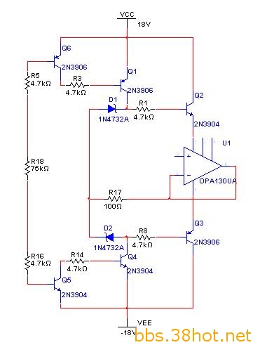

楼上客气了, 老师谈不上。我把新的DC放大器电路图传上来,以飨众生。
AMP_34401A.zip (37 KB, 下载次数: 311)
发表于 2012-12-30 01:05:52 | 显示全部楼层
没看懂哪儿是输入,哪儿是输出
看上图左侧的电路完全可以拆掉
 楼主| 发表于 2012-12-30 22:48:25 | 显示全部楼层
Re楼上
"IN"是输入, "OUT"是输出,左侧是伺服电路,目的是在不同电压的输入信号下,放大器的偏置电流一致;请看上面的分析。
