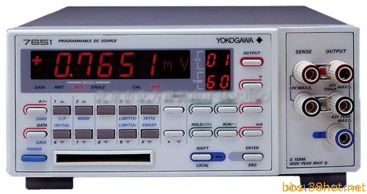

ºáºÓ7651×Գƿɱà³ÌµçÔ´£¬Êµ¼ÊÉ϶àÊýÈ˰ÑËüµ±×öУ׼ԴʹÓá£
ÏÖÔÚ¼òµ¥½éÉÜÆäУ׼·½·¨¡£
1. ºóÃæ°å¿ª¹ØÇл»µ½ Cal,
2. ¿ª»ú Ô¤ÈÈ1Сʱ,
3. Ñ¡ÔñҪУ׼µÄ¹¦Äܺ͵µÎ»£¬±ÈÈç Ö±Á÷µçѹ 100mV µµ,7651ºÍ±ê×¼±íÁ¬½Ó£¬
4. °´ "OUTPUT" £¬¿ªÆô7651µÄÊä³ö,
5. °´ "SHIFT",
6. °´ "1",
7. ¼üÈë±ê×¼±í²âÁ¿Öµ £¬(+ ZEROУ׼£©
8. °´ "ENTER",
9. ¼üÈë±ê×¼±í²âÁ¿Öµ £¨+ FULL SCALEУ׼£©
10. °´ "ENTER"
11. ¼üÈë±ê×¼±í²âÁ¿Öµ£¨ - ZEROУ׼£©
12. °´ "ENTER",
13. ¼üÈë±ê×¼±í²âÁ¿Öµ £¨- FULL SCALEУ׼£©
14. °´ "ENTER",
15. °´ "PRGM/END",
16. Íê³Éºó¹Ø»ú£¬½«ºóÃæ°å¿ª¹ØÇл»µ½ Source,
ËùÐèУ׼µµÎ» 10mV 100mV 1V 10V 30V 1mA 10mA 100mA,
¿ÉÒÔ·Ö¿ªÐ£×¼£¬²»Ò»¶¨Òª¶¼×ö¡£

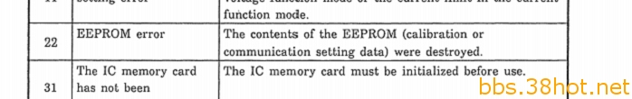

ǰ±² ºáºÓ7651 ¿ª»úÏÔʾerr22 ´úÂë ÊÇɶÎÊÌ⠠лл
 Â¥Ö÷| ·¢±íÓÚ 2012-8-28 16:24:28 | ÏÔʾȫ²¿Â¥²ã
²éÁËÒ»ÏÂÊֲᣬÊÇThe contents of the eeprom (calibration or communication setting data)  were destroyed.
´ó¸ÅµÄÒâ˼£¬ÊÇeeprom(µç¿É²Á¿É±à³ÌÖ»¶Á´æ´¢Æ÷)ÖеÄÄÚÈÝ£¨Ð£×¼»òͨÐÅÉèÖÃÊý¾Ý£©Ë𻵡£ a.JPG
·¢±íÓÚ 2012-8-28 17:34:36 | ÏÔʾȫ²¿Â¥²ã
»Ø bg9ahf µÄÌû×Ó
bg9ahf:ǰ±² ºáºÓ7651 ¿ª»úÏÔʾerr22 ´úÂë ÊÇɶÎÊÌ⠠лл (2012-08-28  14:56)
Æäʵ²¢Ã»»µ£¬¾ÍÊÇУ׼Êý¾ÝÆ«ÀëÌ«¶àÁË£¬Ö¸µÄÊǺÍÄÚ²¿»ù×¼±È¡£ÓÃÍâ»ù׼У¶þ´Î¼´¿É»Ö¸´¡£
